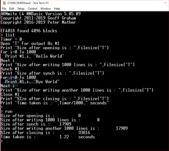

LOAD "filename",r as per Micromite+
Note the new command SYNCH. This flushes the buffer from the flash driver. Until this is done the filesize is not updated and the disk may or may not be written.
Note also, if an existing file is opened for output then filesize will give the size of the previous version of the file until the file is closed or SYNCH is called.
Timer = 0
Open "T" For output As #1
Print "Size after opening is : ",Filesize("T")
For i=0 To 1000
Print #1,i, "Hello World"
Next i
Print "Size after writing 1000 lines is : ",Filesize("T")
Synch #1
Print "Size after synch is : ",Filesize("T")
For i=0 To 1000
Print #1,i, "Bye World"
Next i
Print "Size after writing another 1000 lines is : ",Filesize("T")
Close #1
Print "SIze after closing is : ",Filesize("T")
Print "Time taken is : ",Timer/1000," seconds"
Edited by matherp 2019-03-30

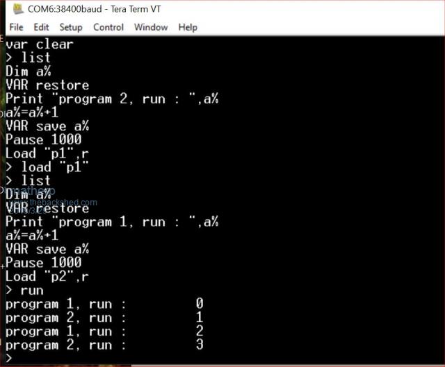

and with that the memory size limit on any program is gone (as if it mattered with the MMX etc...)
Posts: 11968
Posted: 05:32pm 28 Mar 2019
  Quote  and with that the memory size limit on any program is gone (as if it mattered with the MMX etc...)
Yes . Didn't know if this would work but it seems to behave perfectly
Program 1
Dim a%
VAR restore
Print "program 1, run : ",a%
a%=a%+1
VAR save a%
Pause 1000
Load "p2",r
Program 2
Dim a%
VAR restore
Print "program 2, run : ",a%
a%=a%+1
VAR save a%
Pause 1000
Load "p1",r

this is excellent - it is possible to have programs that run as overlays and you simply "page in" the section of code o run.
Question... there is no library with MMX, is there any way to maintain a "kernel" of key functions between overlays int he same way variables survive?
Posts: 11968
Posted: 06:48pm 28 Mar 2019
  Quote  it is possible to have programs that run as overlays and you simply "page in" the section of code o run.
No - sorry, all or nothing
  Quote  Question... there is no library with MMX, is there any way to maintain a "kernel" of key functions between overlays in the same way variables survive?
No: they will need replicating in each program. I didn't include the library in the Armmite L4 as it uses quite a lot of program memory and there is little advantage given that the Armmite doesn't support CFunctions which is where the big space saving gains are found.
  Quote  Interesting... I did not expect variables to keep their values.
They don't. I'm using VAR SAVE to store the value in the uP flash memory and VAR RESTORE to read it back. This is just standard Micromite functionality. Equally I could have written variable values out to the a file and read them back.
