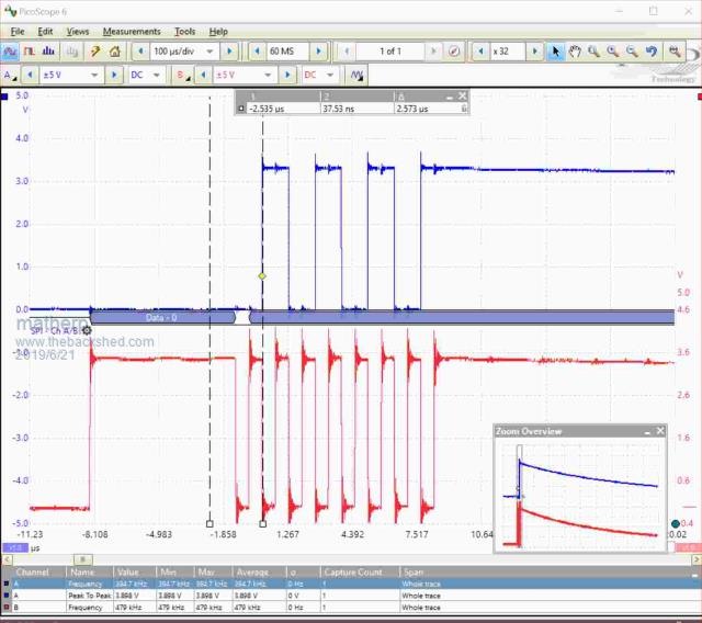

Posts: 11968
Posted: 07:15am 21 Jun 2019
The code posted above definitely works but there is a "funny" with the STM implementation which may be affecting you.
Both the data and clock lines seem to go tri-state off when not in use and the clock voltage will drift down towards 0. If you are using mode 2 or mode 3 then it may be worth trying a 10K pullup on the clock line
The attached version sets a pullup internally when mode 2 or 3 is selected
2019-06-22_193408_Armmite1.3bin.zip
2019-06-22_193425_Armmite1.3hex.zip Edited by matherp 2019-06-23

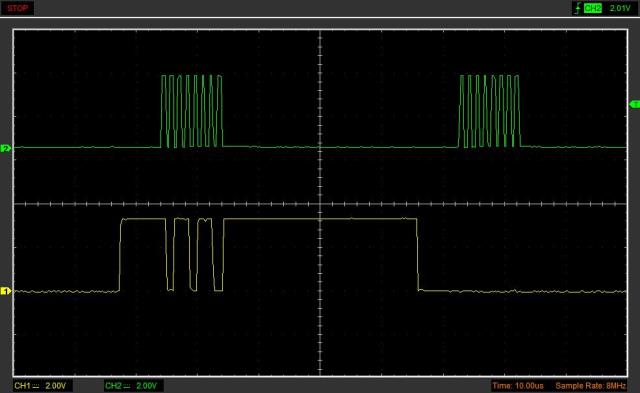

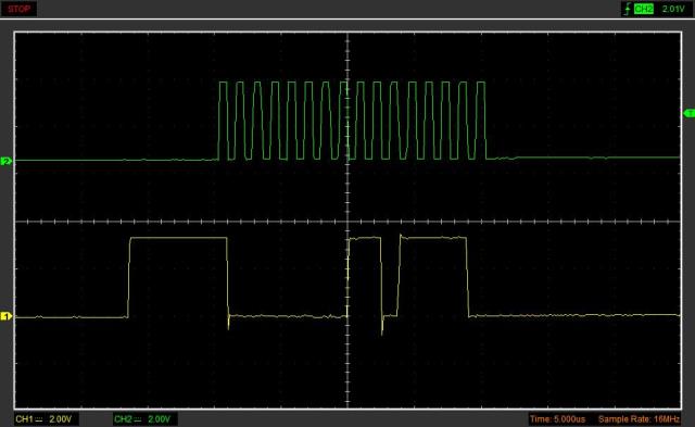

I think I have worked out what is wrong with your 5.0507 firmware for SPI3.
It only clocks 8 bits when a 16 bit write is requested.
Here is the SCK(green) and PIN48 MOSI(yellow) for a 16 bit write ver 5.0507
Here is the SCK(green) and PIN135 MOSI(yellow) for a 16 bit write ver 5.0506
Your SPI3 firmware for 5.0507 has a problem with accepting a 16 bit write.
thanks John
