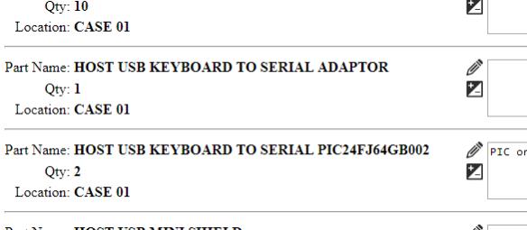

in the absence of a 100% mite solution... I have used this before.
https://www.hobbytronics.co.uk/usb-host-keyboard
you have to use their USB Host Controller Board and then burn this firmware onto it but it works... £15 might be on the expensive side but it got me out of a barcode-reader shaped hole. It was a while ago so hopefully it's still available/doable. Cheapie HID USB barcode readers are all over places like ebay and they work well and seem to last. These tend to be a mix of image/LED based ones that require contact with the barcode (1 dimension) and laser based with oscillating mirror. I tend not to use the former as you'll always find an instance where you cant get the reader head. I did a solution for reading codes on the end of tote baskets and the barcode was in a recess on the end... just narrower than the head of the reader so you couldn't place it over the code properly.
URL=https://www.hobbytronics.co.uk/usb-host-ssop . If you grab some of those PICs from your favourite supplier, you may be able to use their free-download software. It's supplied as a HEX file so no chance of directly using that PIC as your solution... you could disassemble but you'd probably fall foul of licensing https://www.hobbytronics.co.uk/download/usb_host_keyboard_142.zip
EDIT: According to my DB, I have one in stock and two pre-programmed PICs:
so if you get really stuck we could probably come to an arrangement.
Edited by CaptainBoing 2019-07-05
