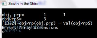

MMBasic for DOS version 5.05.01. Error: Array Dimensions
I get the following eror message
Sub saveGame()
Local loc as Integer, ext as Integer, obj As Integer, prp As Integer, evt As Integer, act As Integer
Open "SITS2.DAT" For Output As #1
Print #1, curLoc
For loc = 1 To maxLoc
For ext = 1 to maxLocExt
Print #1, locExt(loc,ext)e
Next ext
Next loc
For obj = 1 To maxObj
For prp = 1 to maxObjPrp
Print #1, objPrp(obj,prp)
Next prp
Next obj
For evt = 1 To maxEvt
For act = 1 to maxEvtAct
Print #1, evtAct(evt,act)
Next act
Next evt
Close #1
End Sub
Sub loadGame()
Local crLc$, locExit$, objPrp$, evtAct$
Open "SITS2.DAT" For Input As #1
Line Input #1, crLc$ : curLoc = Val(crLc$)
Line Input #1, locExit$ : locExt(loc,ext) = Val(locExit$)
Next ext
Next loc
Print "obj, prp=", obj, prp
Line Input #1, objPrp$
Print "objPrp$=", objPrp$
objPrp(obj,prp) = Val(objPrp$) Error occurs here
Next prp
Next obj
Line Input #1, evtAct$
evtAct(evt,act) = Val(evtAct$) and here
Next act
Next evt
Close #1
End Sub
when executing the load routine in the code below. The save routine works flawlessly. I am baffled.
Print "obj, prp=", obj, prp and
give the expected variable values (see image).
Can anyone help
yours
Henk Koetzier

Posts: 11969
Posted: 03:57pm 13 Jul 2019
You have identical variable names with different attributes
objPrp$ and objPrp(obj,prp)
In modern versions of MMbasic variable names and function names must be unique irrespective of type
In the code posted the two dimensional array objPrp(m,n) isn't defined at all. It could be a function or an array but in either case it conflicts with objPrp$ inside Sub loadGame()
Inside a function the parser first searches the LOCAL variables. In your case it finds objPrp which it knows is a simple string variable. But then it sees objPrp(obj,prp) which conflicts with the cardinality of objPrp$
Edited by matherp 2019-07-15

Posted: 07:34pm 14 Jul 2019
Thx Matherp, renaming the string variables worked.
For the record objPrp(..) and evtAct(..) are defined as global arrays elsewhere in the program.
