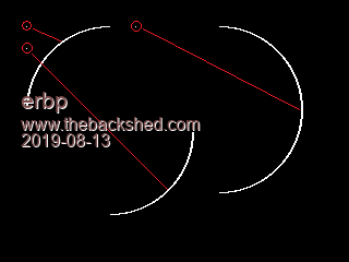

When using the ARC command on an ARMmite F4 (Ver 5.05.08) I am getting an extra pixel displayed. It appears to be at the top left corner of the imaginary square enclosing the circle that the arc is a part of. I have tried a couple of F4 modules and different LCD panels, but the results are always the same. See below image for an example. These arcs were drawn using the following 3 commands:
ARC 200,100,75,76,0,180
ARC 100,100,75,76,270,360
ARC 100,120,75,76,90,180
As I'm not sure how well the single pixel points will show up in the image I have circled where they are and drawn a link to which arc each is associated with.
Could you please take a look at this?

Posts: 11971
Posted: 08:17am 13 Aug 2019
  Quote  Could you please take a look at this?
Stupid boundary condition error - will fix in the next release

Posted: 10:51am 14 Aug 2019
Confirming that the 2019-08-13_222508_ArmmiteF4.hex firmware fixes the issue with the unwanted pixels.
