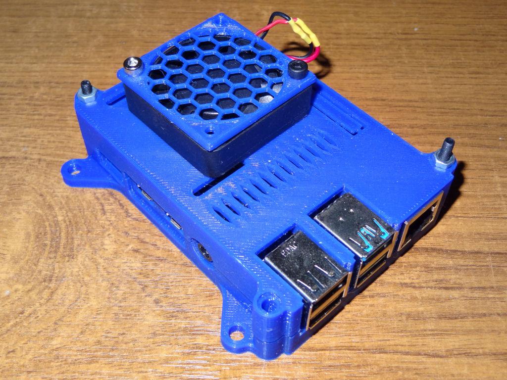

Posted: 03:59pm 14 Oct 2019
Sounds like a big fan for a little Pi!
I went for a little 5V fan that's powered via the Pi GPIO: 40 x 40 x 10 mm - it's not silent, but it's not loud enough to bother me.
I really should replace the all-thread plus nuts holding the case together with some proper fasteners.
Edited 2019-10-15 02:01 by ceptimus
What case is that ?
Neat looking .....

Posted: 06:59pm 14 Oct 2019
It's on Thingiverse: https://www.thingiverse.com/thing:1815268/files
Everything is there including the fan cover.
Only thing that wasn't quite right was that the stand-offs inside the case that the Pi sits on have their holes a bit too big.  The stand-offs and holes are perfectly positioned, but self-tapper screws small enough to pass through the fixing holes in the Pi are too loose a fit in the stand offs to tap properly.  I fixed that by plugging the holes in the stand offs with hot-melt glue, then drilling pilot holes in the glue and threading the self-tappers into those.  Epoxy glue would probably be better than hot glue, providing you wait for it to fully set before drilling it and fastening the Pi to it!
Edited 2019-10-15 05:02 by ceptimus
