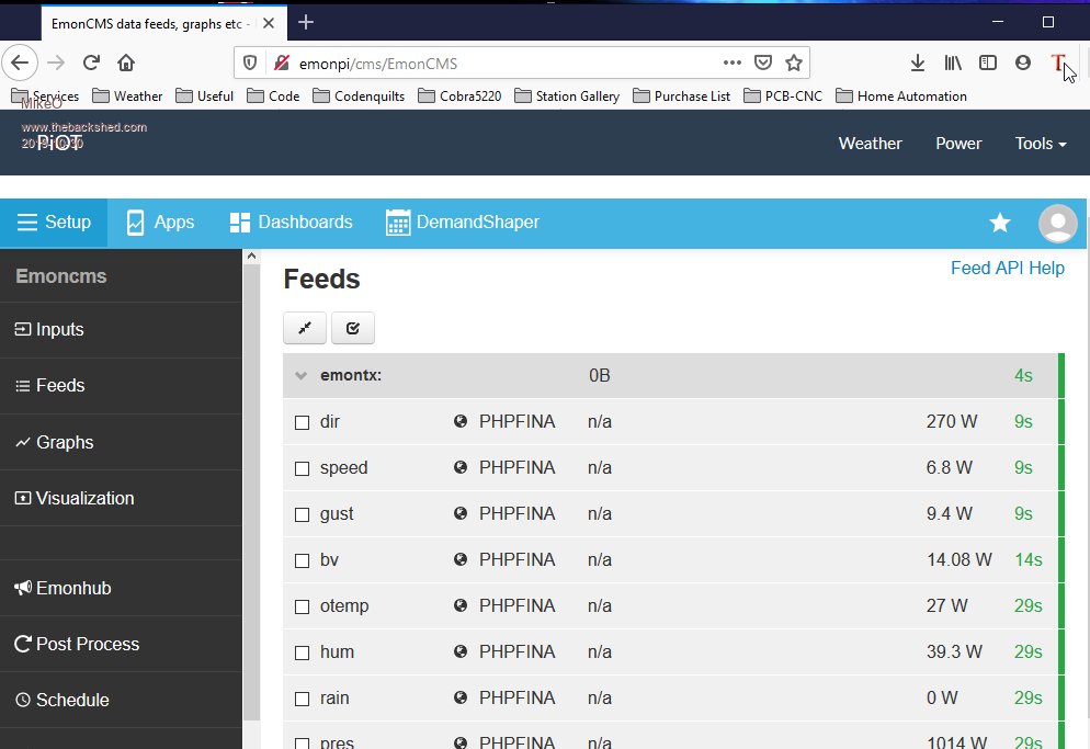

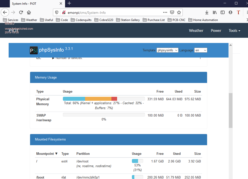

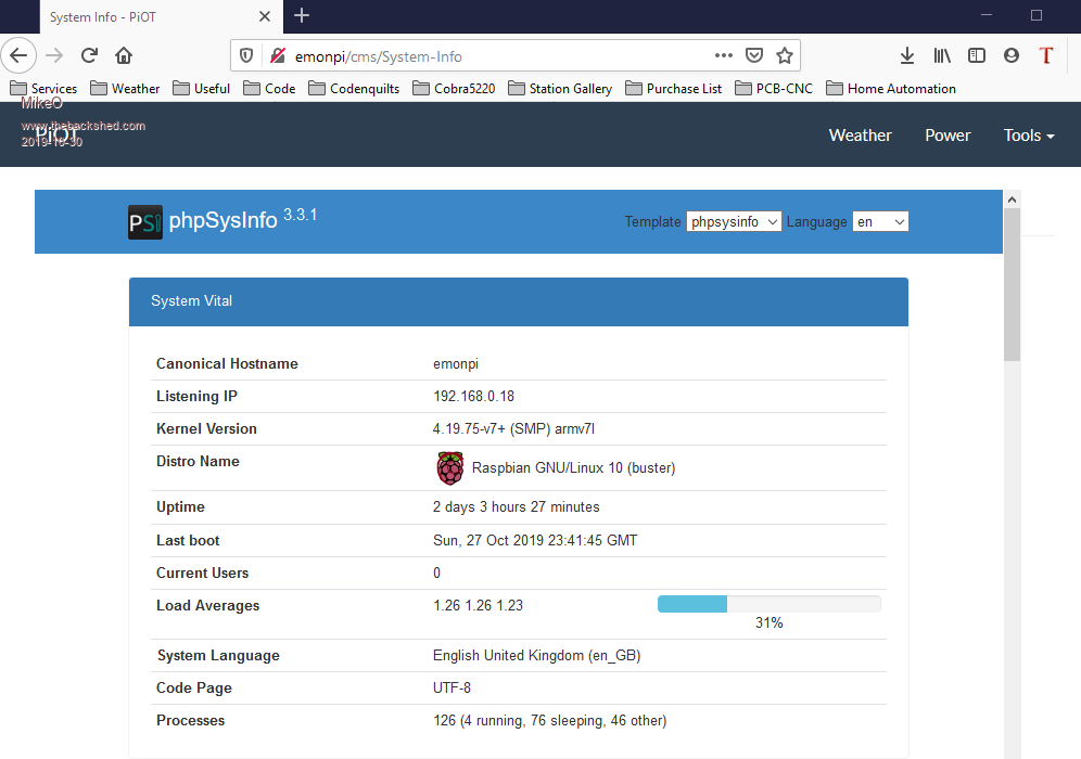

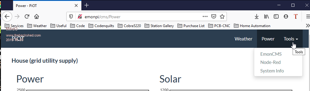

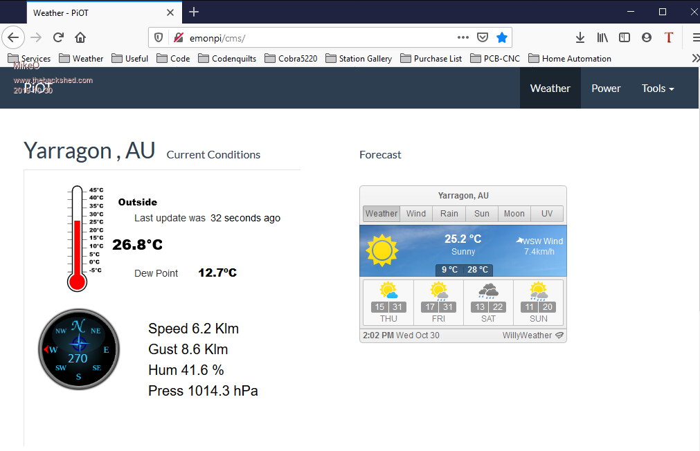

PiOT is the name I have given to a Raspberry Pi image I have made. Like many I imagine I have been experimenting with home data collection for several years, micromites, ESP8266 but more recently Raspberry Pi. I tried the RPI with mmbasic some time ago and that was successful but since I have spent a lot more time playing with Linux itself, that opens up a whole lot more possibilities.
So to PiOT, silly name but i had to call it something! As the basis of the image is a PHP app called EmonCMS which is part of the Open Energy Project in the UK but it is a terrific application for logging data, it also has great facilities for Visualizations and Graphing. EmonCMS coupled with Node-Red , mmbasic and a Simple but Powerful CMS (Typesetter CMS 5.1) for a Web U/I. All this wrapped together as a "ready to go" RPI image , for me , makes the basis of a nice Home Automation System with fairly limitless functionality but could also easily be a quick way to a logger/controller for many other projects.
The image is running Raspian Buster and is pre-configured as a headless system it has  MMbasic installed which starts in a screen session on boot up so at the very least the img is an easy way to try Picromite.
I will make the image available if any one want to try it anf will start some documentation on my website.  Mike
Here are a few screens from my working system.

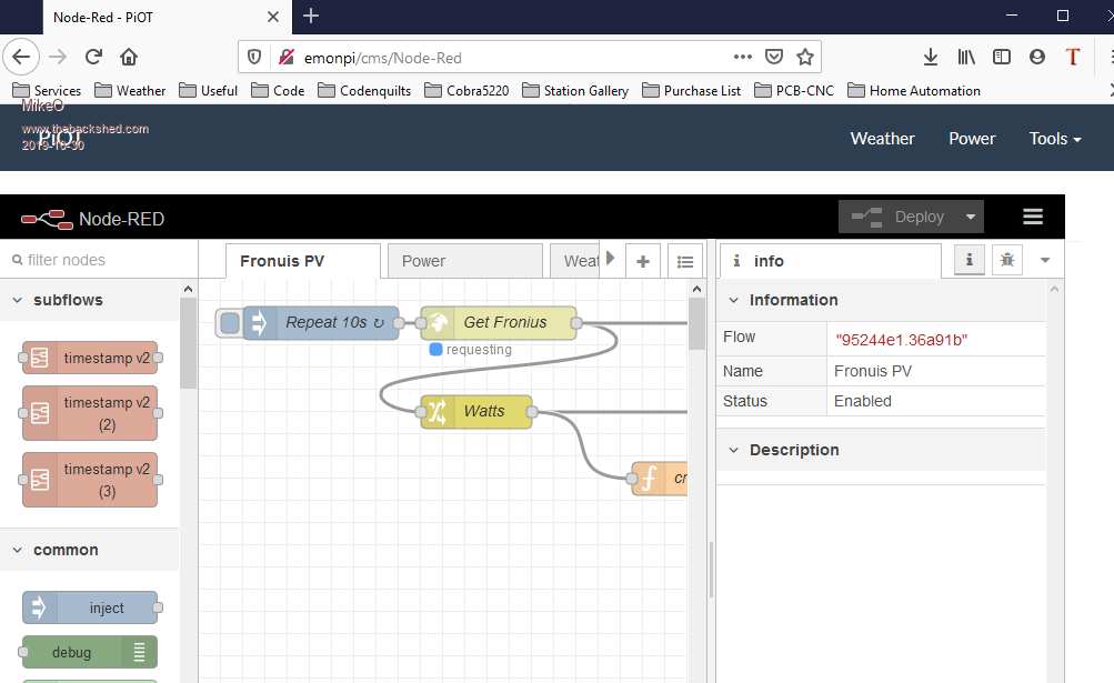

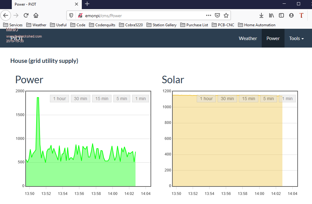

Hi Lizby, mmbasic plays no part in the Web interface. It is just one of the tools available in the "compilation" .
In my case, for my current project for example , mmbasic performs some processing of my Grid electricity and roof PV supply data , it collects the data via UDP transmissions from the sensors, calculates then saves the results in a file. Node Red then reads the file and passes them on to the logger. Data from different sensors can be stitched together , logged , displayed etc by using the various applications as required.
The image is based on Buster, I have not really tried a Zero , I think it would be asking too much .
I will be posting the image tomorrow with some documentation.
