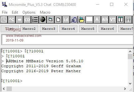

I am using a ZI2 Board, but I still see the escape characters on the console, even  when using the most recent firmware
> [?1000l
> [?1000l
> ARMmite MMBasic Version 5.05.10
Copyright 2011-2019 Geoff Graham
Copyright 2016-2019 Peter Mather
[?1000l>
I have re-tested the background ADC sampling and it continues to work just fine following the permanent fix.

Rodgerg
Joined: 13/10/2019
Posts: 13
Posted: 08:59am 09 Nov 2019
@KeepIs  Thanks for clarification Mike.
  Quote  depending on the external terminal program you are using, they may well be visible on that.
Your are absolutely correct.
I have been using MMEdit Chat as my terminal program until now as everything is nicely integrated in MMEDit for editing, uploading and controlling the Micromite.
Full screenshot below
With Teraterm, it looks like this
Much better
So, biting the bullet, I added the file upload and time setting macros to TeraTerm as per the MMEdit manual instructions for working with TeraTerm.

I may still use MMEdit Chat for small tests, but the control codes appearing on the screen are a little annoying.
One thing I will really miss about MMEdit Chat though is the Linux-like ability to scroll back through recent commands with the up and down arrows, which I assume uses some form of keystroke buffer.
Thanks for your help
Rodger.
Edited 2019-11-09 18:59 by Rodgerg
Posts: 6638
Posted: 08:45pm 09 Nov 2019
MMEdit hasn't kept up with recent changes to some of the MMBasic variants.
I will update it eventually but TeraTerm will always be a much better terminal program.
