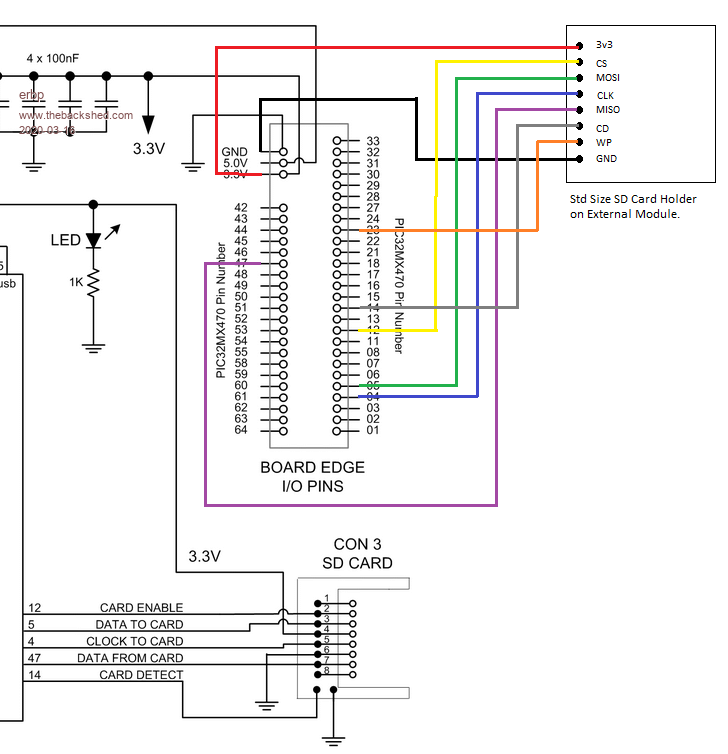

Hi,
I am not sure if this is a bug or I have a problem with my E64.
The situation I have is an early model E64 (version 1C) which I am using with an external SDCard holder/module connected in parallel to the onboard micro SDCard holder on the E64. The external module supports a Write Protect pin (which as far as I know the onboard module doesn't). So I configure the SDCard with OPTION SDCARD 12,14,-23  - having the WP pin connected to MM+ pin 23 and requiring the polarity of the WP signal to be inverted.
With this configuration I can access the SDCard successfully except for when I try to OPEN a file for OUTPUT, APPEND or RANDOM - these all cause the same error : CPU exception #7 (bus error on load or store) at address 0x9D049AB8. These open modes will all require the Write Protect status to be checked. OPEN for INPUT works fine.
Now if I leave off the WP pin from the configuration (so just OPTION SDCARD 12,14) everything works OK, no CPU exception for any file access mode.  Also if I specify the WP pin without the negative sign, again no CPU exception, but of course if I try to open a file for OUTPUT, APPEND or RANDOM, MMBasic reports that the SDCard is write protected.
I have tried re-flashing the E64 multiple times - no change to the problem. I have also tried a few different MM+ pins for the WP signal, again no effect.
Now the really confusing bit is that I also have an E100 using the same model external SDCard holder/module and with the SDCard configured as OPTION SDCARD 52,53,-17 and no problems with CPU exceptions. It is quite happy to allow files to be opened for OUTPUT, APPEND or RANDOM!!
Unfortunately I don't have a second E64 module so I can't try a different CPU chip to see if that is where the problem lies. Can anyone test this or shed any light as to whether this is a bug that affects specifically the 64 pin MM+?

I put here 2 schemas, one for E64 and other for E100. You can see that SdCard are not sames, in E64 there is no WP signal, only CE and CD.
I think that your problem is here

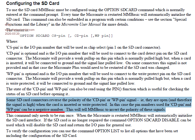

Yes and No - Yes, I agree that the E64 module does not support the WP signal. That is because it has a Micro SDCard holder fitted and Micro SDCards do not support Write Protection. So the PCB has no track for WP, nor is there a pin assigned on the CPU chip.
No, because I am not using the Micro SDCard holder fitted to the E64 board. I have a standard size SDCard holder fitted to an EXTERNAL module. This holder DOES support Write Protection and has a WP pin on its interface. Below is a partial image of the schematic showing how my external SDCard is connected to the E64.
The Micromite Plus Manual v5.05.02 page 19 shows that the OPTION SDCARD command includes the WP pin specification as an option. No where that I can find does it state that use of the WP pin is unsupported on the E64. I should therefore be able to connect the WP signal to any spare pin on the CPU and specify that pin in the OPTION SDCARD command.
So I don't think this is the answer.

Yes it is most definitely related to the WP pin being specified as a negative number! I thought I had stated this in a previous post. If I specify OPTION SDCARD 12,14,23 - i.e. NOT inverting the WP signal, the CPU Exception does NOT occur. In this case however MMBasic will report an error for any attempt to write to the SDCard as it 'thinks' the card is Write Disabled which is to be expected.
As for whether the pin number can be specified as a negative to imply signal inversion - the following is an extract from the Micromite Plus manual - v5.05.02 (my highlighting).
