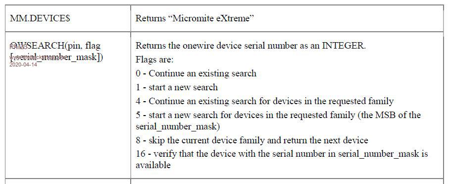

Is there somewhere basic program for Micromite to search ONE WIRE bus? I tried to make sense of the Maxim flowchart but can't figure it out. I can read 1 or 2 devices but when I connect more, my search fails or runs in never-ending loop.

I have never used it directly (if you discount the DS18B20 temp sensor where I use TEMPR) but, One-wire support is part of MMBasic. Taking a look at Appendix C of the Micromite Manual;
It says "For users of MMBasic on earlier devices... The OWSEARCH command and the OWCRC8() and OWCRC16() functions are not implemented", so I suspect any querying of the bus would be successive progression of the READ and dealing with null-responses (MM.ONEWIRE) - don't know what qualifies as "earlier"(?)

  CaptainBoing said  It says... "The OWSEARCH command and the OWCRC8() and OWCRC16() functions are not implemented"
I've got a vague recollection that matherp revisited OWSearch at one point in the MMExtreme firmware.
On checking the function is mentioned on Page 29 of the 5.3.15 MM Extreme Manual I have here.
Have never got to try in on my MMX though.
