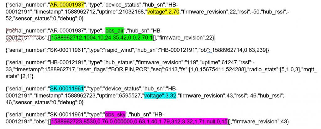

I'm trying to parse data from the UDP port on my router to collect my Weatherflow data
I've managed to figure out how to get the UDP packets
What I need to parse is the coloured sections in the snippet of what's received below
The obs section contains all the relevant data I need to collect like windspeed, direction temp etc
Can anyone help with telling me how to parse this data?
I "think" it could be done by trying to capture the data starting with serial number
for example
if "serial_number": = "AR-00001937"," then print ,"voltage":
if "serial_number": = "AR-00001937"," then print ,"obs":
if "serial_number": = "SK-00011961," then print ,"voltage":
if "serial_number": = "SK-00011961"," then print ,"obs":
But no idea how to do it

What I'm trying to get is the parts coloured below
IF RED then parse the BLUE sections
{"serial_number":"SK-00011961","type":"obs_sky","hub_sn":"HB-00012191","obs":[[1589011848,32799,2.67,0.000000,0.04,0.68,2.01,169,3.34,1,273,null,0,3]],"firmware_revision":43}
{"serial_number":"AR-00001937","type":"obs_air","hub_sn":"HB-00012191","obs":[[1589011895,1002.80,25.05,41,0,0,2.70,1]],"firmware_revision":22}
I would normally be able to do it by doing something like
voltage$=JSON$(a(),"AR-00001937.voltage")'Voltage
I know I can parse the obs bit by using comma parsing but
The problem I have is the UDP port sends out several different packets with different information and I only want the specified bits
Is there a way to do
IF obs_sky then parse obs
IF obs_air then parse obs but I need a way to differentiate the results so I can display them properly
if "SK-00011961","type":"device_status" then parse obs (but identify it as obs_sky)
if "AR-00001937","type":"device_status" then parse obs (but identify it as obs_air)
Can anyone suggest a way to do this?

  lew247 said  What I'm trying to get is the parts coloured below
if "SK-00011961","type":"obs_sky" then parse obs (but identify it as obs_sky)
if "AR-00001937","type":"obs_air" then parse obs (but identify it as obs_air)
