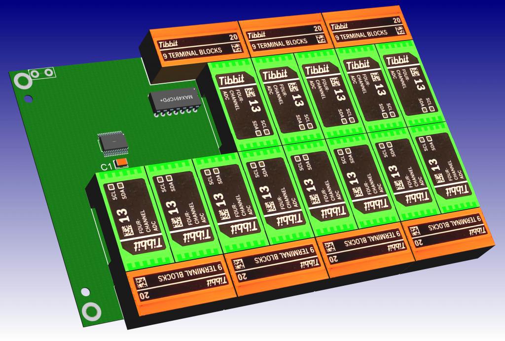

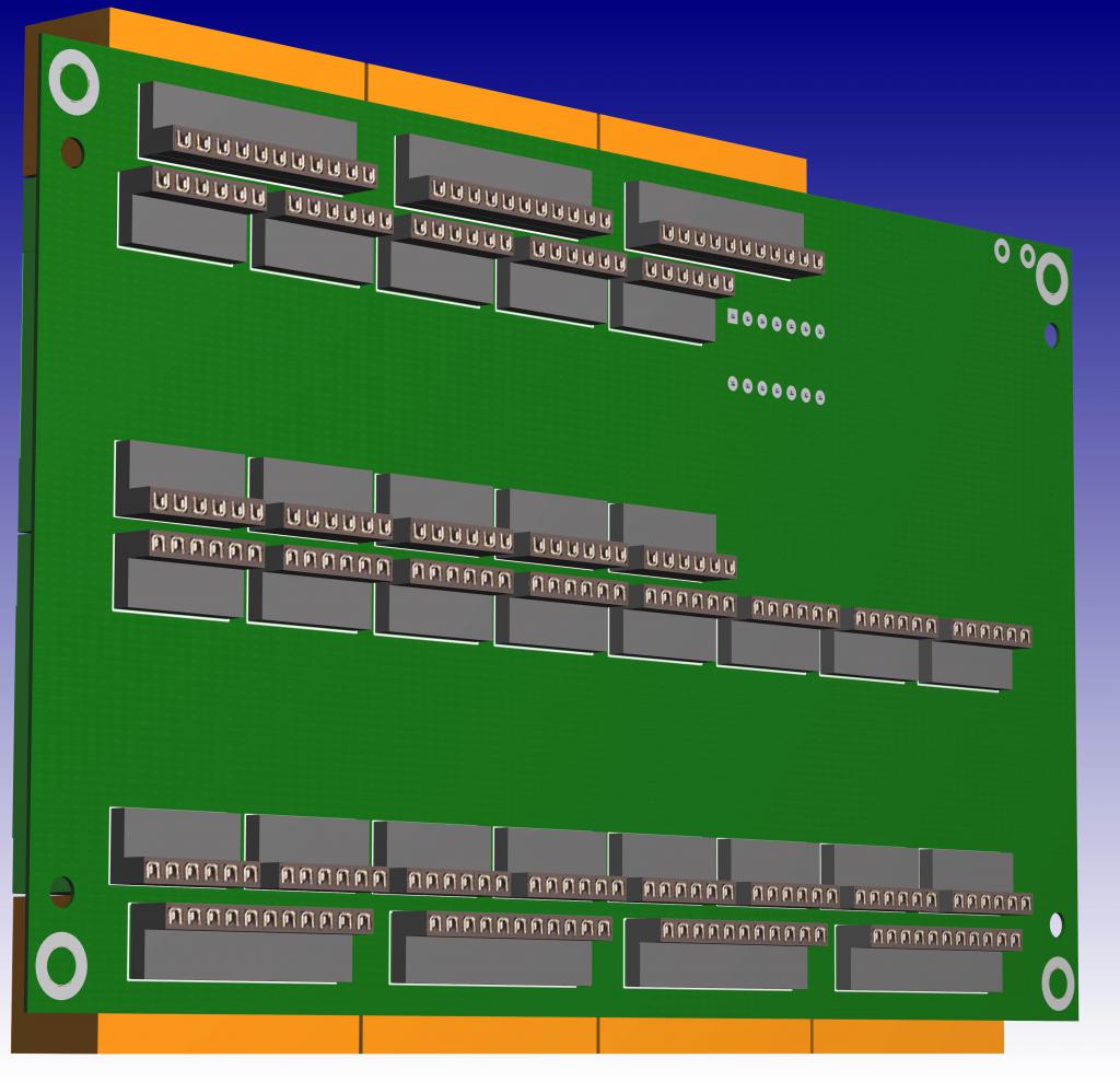

Posts: 2981
Posted: 05:38am 17 Jul 2020
Hi Craig, All,
  Tinine said  if my partner-in-crime feels that this is an appropriate time to show a preview of the WIP, then it's cool by me
Craig
I wonder who that might be?
I have little more than the base layout and a couple of 3D renderings to show..
Apart from the special sockets that mount on the underside of the board that accept pins inserted from the top side of the board.
The layout of the Pic's and other components shouldnt take too long once we have settled on a design that works.

Tinine
Joined: 30/03/2016
Posts: 1646
Posted: 08:18am 17 Jul 2020
The idea is to end-up with a MMbasic controlled device that looks like a "bought one".
It's based on the Tibbo system and utilises the reasonably priced Tibbit Blocks
I am not impressed with Tibbo's own motherboard due to the fact that it's easy to run in to limitations when using their Online Configurator
Furthermore, their BASIC/C languages are compiled and don't even have a mS timer function. For control purposes, I rely on passive time delays.
The Tibbit blocks, on the CPU side can require SPI, I2C, serial or DIO. By having a MX170 slave serving every 4 of the module sockets, much more flexibility will be possible and of course, each MX170 can be programmed to suit and can feature local, autonomous procedures.
This particular motherboard has been designed to fit the Size 3 Project Box which even comes with really nice packaging (cardboard box).
All kinds of neat parts are available, including "light guides" to bring led illumination from the PCB to the left of the box lid. Also, Tibbit shells are available for our own custom modules.
Craig
