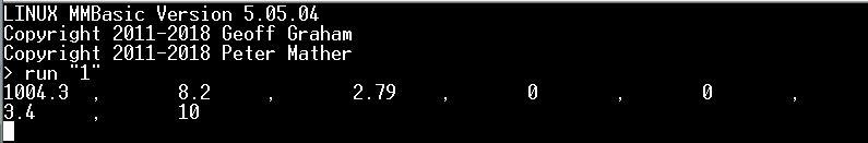

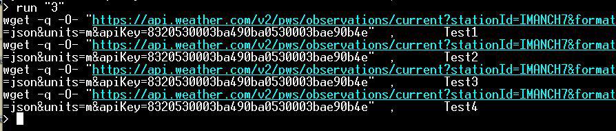

lew247
Joined: 23/12/2015
Posts: 1709
Posted: 03:32pm 26 Nov 2020
Dim As integer d(1000)
DIM STRING q=Chr$(34) '" symbol
DIM icon$,icon1$,icon2$,icon3$
system "wget -q -O- "+q$+"https://api.weather.com/v2/pws/observations/current?stationId=IMANCH7&format=json&units=m&apiKey=8320530003ba490ba0530003bae90b4e"+q$,d()
icon$=JSON$(d%(),"list[0].weather[0].icon")
icon1$=JSON$(d%(),"list[0].weather[1].icon")
icon2$=JSON$(d%(),"list[1].weather[0].icon")
icon3$=JSON$(d%(),"list[1].weather[1].icon")
print icon$,",","Test1"
print icon1$,",","Test2"
print icon2$,",","Test3"
print icon3$,",","Test4"
I really don't get why it isn't working
I've left the API key in there in case anyone wants to see if it's working their end
Edited 2020-11-27 01:43 by lew247

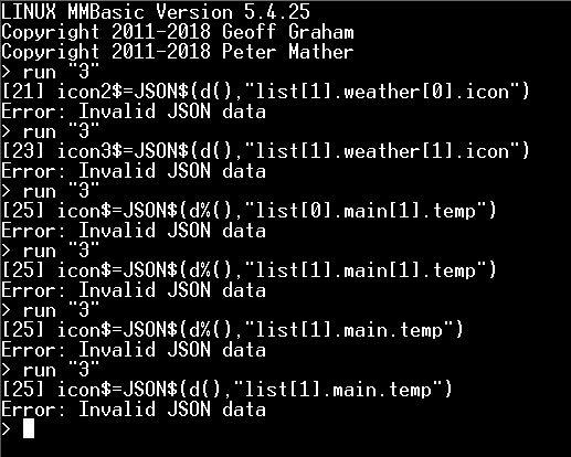

lew247
Joined: 23/12/2015
Posts: 1709
Posted: 05:33pm 26 Nov 2020
  lizby said  What is actually returned by your wget? Which I'm guessing is put into the integer array d() (which I suppose is actually a LONGSTRING)? This is, if you do
LONGSTRING PRINT d%()
I'm an idiot I had the wrong page I was calling
But I tried it again with the correct api address and got this
ERROR: Invalid JSON data
When I do LONGSTRING PRINT d%() I get this - but with no linefeeds
I can't copy and past from Pi-Crommite
  Quote  {"cod":"200","message":0,"cnt":40,"list":[{"dt":1606413600,"main":{"temp":279.93,"feels_like":277.68,"temp_min":279.32,"temp_max":279.93,"pressure":1021,"sea_level":1021,"grnd_level":1007,"humidity":85,"temp_kf":0.61},"weather":[{"id":803,"main":"Clouds","description":"broken clouds","icon":"04n"}],"clouds":{"all":80},"wind":{"speed":1.45,"deg":204},"visibility":10000,"pop":0,"sys":{"pod":"n"},"dt_txt":"2020-11-26 18:00:00"},{"dt":1606424400,"main":{"temp":278.63,"feels_like":276.42,"temp_min":278.11,"temp_max":278.63,"pressure":1022,"sea_level":1022,"grnd_level":1008,"humidity":89,"temp_kf":0.52},"weather":[{"id":802,"main":"Clouds","description":"scattered clouds","icon":"03n"}],"clouds":{"all":50},"wind":{"speed":1.23,"deg":204},"visibility":10000,"pop":0,"sys":{"pod":"n"},"dt_txt":"2020-11-26 21:00:00"},{"dt":1606435200,"main":{"temp":277.57,"feels_like":275.57,"temp_min":277.37,"temp_max":277.57,"pressure":1022,"sea_level":1022,"grnd_level":1008,"humidity":91,"temp_kf":0.2},"weather":[{"id":802,"main":"Clouds","description":"scattered clouds","icon":"03n"}],"clouds":{"all":38},"wind":{"speed":0.73,"deg":252},"visibility":10000,"pop":0,"sys":{"pod":"n"},"dt_txt":"2020-11-27 00:00:00"},{"dt":1606446000,"main":{"temp":277.22,"feels_like":275.3,"temp_min":277.19,"temp_max":277.22,"pressure":1021,"sea_level":1021,"grnd_level":1008,"humidity":90,"temp_kf":0.03},"weather":[{"id":802,"main":"Clouds","description":"scattered clouds","icon":"03n"}],"clouds":{"all":49},"wind":{"speed":0.49,"deg":33},"visibility":10000,"pop":0,"sys":{"pod":"n"},"dt_txt":"2020-11-27 03:00:00"},{"dt":1606456800,"main":{"temp":276.55,"feels_like":274.19,"temp_min":276.55,"temp_max":276.55,"pressure":1021,"sea_level":1021,"grnd_level":1007,"humidity":88,"temp_kf":0},"weather":[{"id":802,"main":"Clouds","description":"scattered clouds","icon":"03n"}],"clouds":{"all":32},"wind":{"speed":0.89,"deg":82},"visibility":10000,"pop":0,"sys":{"pod":"n"},"dt_txt":"2020-11-27 06:00:00"},{"dt":1606467600,"main":{"temp":276.7,"feels_like":274.44,"temp_min":276.7,"temp_max":276.7,"pressure":1020,"sea_level":1020,"grnd_level":1007,"humidity":83,"temp_kf":0},"weather":[{"id":800,"main":"Clear","description":"clear sky","icon":"01d"}],"clouds":{"all":5},"wind":{"speed":0.59,"deg":104},"visibility":10000,"pop":0,"sys":{"pod":"d"},"dt_txt":"2020-11-27 09:00:00"},{"dt":1606478400,"main":{"temp":279.3,"feels_like":277.06,"temp_min":279.3,"temp_max":279.3,"pressure":1019,"sea_level":1019,"grnd_level":1006,"humidity":70,"temp_kf":0},"weather":[{"id":800,"main":"Clear","description":"clear sky","icon":"01d"}],"clouds":{"all":2},"wind":{"speed":0.6,"deg":244},"visibility":10000,"pop":0,"sys":{"pod":"d"},"dt_txt":"2020-11-27 12:00:00"},{"dt":1606489200,"main":{"temp":278.7,"feels_like":276.48,"temp_min":278.7,"temp_max":278.7,"pressure":1018,"sea_level":1018,"grnd_level":1004,"humidity":74,"temp_kf":0},"weather":[{"id":800,"main":"Clear","description":"clear sky","icon":"01d"}],"clouds":{"all":5},"wind":{"speed":0.61,"deg":168},"visibility":10000,"pop":0,"sys":{"pod":"d"},"dt_txt":"2020-11-27 15:00:00"},{"dt":1606500000,"main":{"temp":277.17,"feels_like":274.62,"temp_min":277.17,"temp_max":277.17,"pressure":1018,"sea_level":1018,"grnd_level":1004,"humidity":81,"temp_kf":0},"weather":[{"id":802,"main":"Clouds","description":"scattered clouds","icon":"03n"}],"clouds":{"all":42},"wind":{"speed":1.03,"deg":102},"visibility":10000,"pop":0,"sys":{"pod":"n"},"dt_txt":"2020-11-27 18:00:00"},{"dt":1606510800,"main":{"temp":276.58,"feels_like":273.81,"temp_min":276.58,"temp_max":276.58,"pressure":1018,"sea_level":1018,"grnd_level":1004,"humidity":83,"temp_kf":0},"weather":[{"id":804,"main":"Clouds","description":"overcast clouds","icon":"04n"}],"clouds":{"all":100},"wind":{"speed":1.3,"deg":99},"visibility":10000,"pop":0,"sys":{"pod":"n"},"dt_txt":"2020-11-27 21:00:00"},{"dt":1606521600,"main":{"temp":276.07,"feels_like":272.98,"temp_min":276.07,"temp_max":276.07,"pressure":1018,"sea_level":1018,"grnd_level":1004,"humidity":82,"temp_kf":0},"weather":[{"id":803,"main":"Clouds","description":"broken clouds","icon":"04n"}],"clouds":{"all":62},"wind":{"speed":1.61,"deg":90},"visibility":10000,"pop":0,"sys":{"pod":"n"},"dt_txt":"2020-11-28 00:00:00"},{"dt":1606532400,"main":{"temp":277.75,"feels_like":274.5,"temp_min":277.75,"temp_max":277.75,"pressure":1018,"sea_level":1018,"grnd_level":1004,"humidity":83,"temp_kf":0},"weather":[{"id":804,"main":"Clouds","description":"overcast clouds","icon":"04n"}],"clouds":{"all":93},"wind":{"speed":2.25,"deg":75},"visibility":10000,"pop":0,"sys":{"pod":"n"},"dt_txt":"2020-11-28 03:00:00"},{"dt":1606543200,"main":{"temp":277.09,"feels_like":274.17,"temp_min":277.09,"temp_max":277.09,"pressure":1018,"sea_level":1018,"grnd_level":1005,"humidity":92,"temp_kf":0},"weather":[{"id":803,"main":"Clouds","description":"broken clouds","icon":"04n"}],"clouds":{"all":70},"wind":{"speed":1.97,"deg":73},"visibility":10000,"pop":0,"sys":{"pod":"n"},"dt_txt":"2020-11-28 06:00:00"},{"dt":1606554000,"main":{"temp":278.18,"feels_like":275.43,"temp_min":278.18,"temp_max":278.18,"pressure":1020,"sea_level":1020,"grnd_level":1006,"humidity":91,"temp_kf":0},"weather":[{"id":803,"main":"Clouds","description":"broken clouds","icon":"04d"}],"clouds":{"all":55},"wind":{"speed":1.96,"deg":80},"visibility":10000,"pop":0,"sys":{"pod":"d"},"dt_txt":"2020-11-28 09:00:00"},{"dt":1606564800,"main":{"temp":280.67,"feels_like":278,"temp_min":280.67,"temp_max":280.67,"pressure":1020,"sea_level":1020,"grnd_level":1007,"humidity":86,"temp_kf":0},"weather":[{"id":803,"main":"Clouds","description":"broken clouds","icon":"04d"}],"clouds":{"all":72},"wind":{"speed":2.31,"deg":97},"visibility":10000,"pop":0,"sys":{"pod":"d"},"dt_txt":"2020-11-28 12:00:00"},{"dt":1606575600,"main":{"temp":280.76,"feels_like":278.33,"temp_min":280.76,"temp_max":280.76,"pressure":1020,"sea_level":1020,"grnd_level":1007,"humidity":87,"temp_kf":0},"weather":[{"id":804,"main":"Clouds","description":"overcast clouds","icon":"04d"}],"clouds":{"all":100},"wind":{"speed":2.03,"deg":82},"visibility":10000,"pop":0,"sys":{"pod":"d"},"dt_txt":"2020-11-28 15:00:00"},{"dt":1606586400,"main":{"temp":280.04,"feels_like":277.29,"temp_min":280.04,"temp_max":280.04,"pressure":1022,"sea_level":1022,"grnd_level":1008,"humidity":91,"temp_kf":0},"weather":[{"id":804,"main":"Clouds","description":"overcast clouds","icon":"04n"}],"clouds":{"all":90},"wind":{"speed":2.47,"deg":83},"visibility":10000,"pop":0,"sys":{"pod":"n"},"dt_txt":"2020-11-28 18:00:00"},{"dt":1606597200,"main":{"temp":279.79,"feels_like":277.48,"temp_min":279.79,"temp_max":279.79,"pressure":1023,"sea_level":1023,"grnd_level":1009,"humidity":93,"temp_kf":0},"weather":[{"id":802,"main":"Clouds","description":"scattered clouds","icon":"03n"}],"clouds":{"all":38},"wind":{"speed":1.86,"deg":85},"visibility":10000,"pop":0,"sys":{"pod":"n"},"dt_txt":"2020-11-28 21:00:00"},{"dt":1606608000,"main":{"temp":278.98,"feels_like":276.82,"temp_min":278.98,"temp_max":278.98,"pressure":1024,"sea_level":1024,"grnd_level":1010,"humidity":93,"temp_kf":0},"weather":[{"id":801,"main":"Clouds","description":"few clouds","icon":"02n"}],"clouds":{"all":23},"wind":{"speed":1.42,"deg":85},"visibility":10000,"pop":0,"sys":{"pod":"n"},"dt_txt":"2020-11-29 00:00:00"},{"dt":1606618800,"main":{"temp":278.59,"feels_like":276.43,"temp_min":278.59,"temp_max":278.59,"pressure":1024,"sea_level":1024,"grnd_level":1011,"humidity":90,"temp_kf":0},"weather":[{"id":800,"main":"Clear","description":"clear sky","icon":"01n"}],"clouds":{"all":2},"wind":{"speed":1.18,"deg":77},"visibility":10000,"pop":0,"sys":{"pod":"n"},"dt_txt":"2020-11-29 03:00:00"},{"dt":1606629600,"main":{"temp":278.38,"feels_like":275.95,"temp_min":278.38,"temp_max":278.38,"pressure":1025,"sea_level":1025,"grnd_level":1011,"humidity":87,"temp_kf":0},"weather":[{"id":800,"main":"Clear","description":"clear sky","icon":"01n"}],"clouds":{"all":1},"wind":{"speed":1.39,"deg":79},"visibility":10000,"pop":0,"sys":{"pod":"n"},"dt_txt":"2020-11-29 06:00:00"},{"dt":1606640400,"main":{"temp":278.59,"feels_like":276.39,"temp_min":278.59,"temp_max":278.59,"pressure":1026,"sea_level":1026,"grnd_level":1012,"humidity":86,"temp_kf":0},"weather":[{"id":800,"main":"Clear","description":"clear sky","icon":"01d"}],"clouds":{"all":0},"wind":{"speed":1.07,"deg":83},"visibility":10000,"pop":0,"sys":{"pod":"d"},"dt_txt":"2020-11-29 09:00:00"},{"dt":1606651200,"main":{"temp":281.48,"feels_like":279.83,"temp_min":281.48,"temp_max":281.48,"pressure":1026,"sea_level":1026,"grnd_level":1012,"humidity":74,"temp_kf":0},"weather":[{"id":800,"main":"Clear","description":"clear sky","icon":"01d"}],"clouds":{"all":0},"wind":{"speed":0.47,"deg":118},"visibility":10000,"pop":0,"sys":{"pod":"d"},"dt_txt":"2020-11-29 12:00:00"},{"dt":1606662000,"main":{"temp":280.75,"feels_like":279.2,"temp_min":280.75,"temp_max":280.75,"pressure":1026,"sea_level":1026,"grnd_level":1012,"humidity":78,"temp_kf":0},"weather":[{"id":800,"main":"Clear","description":"clear sky","icon":"01d"}],"clouds":{"all":0},"wind":{"speed":0.34,"deg":231},"visibility":10000,"pop":0,"sys":{"pod":"d"},"dt_txt":"2020-11-29 15:00:00"},{"dt":1606672800,"main":{"temp":279.32,"feels_like":277.31,"temp_min":279.32,"temp_max":279.32,"pressure":1027,"sea_level":1027,"grnd_level":1013,"humidity":82,"temp_kf":0},"weather":[{"id":800,"main":"Clear","description":"clear sky","icon":"01n"}],"clouds":{"all":0},"wind":{"speed":0.81,"deg":155},"visibility":10000,"pop":0,"sys":{"pod":"n"},"dt_txt":"2020-11-29 18:00:00"},{"dt":1606683600,"main":{"temp":278.6,"feels_like":276.73,"temp_min":278.6,"temp_max":278.6,"pressure":1027,"sea_level":1027,"grnd_level":1014,"humidity":85,"temp_kf":0},"weather":[{"id":800,"main":"Clear","description":"clear sky","icon":"01n"}],"clouds":{"all":5},"wind":{"speed":0.56,"deg":209},"visibility":10000,"pop":0,"sys":{"pod":"n"},"dt_txt":"2020-11-29 21:00:00"},{"dt":1606694400,"main":{"temp":278,"feels_like":276.04,"temp_min":278,"temp_max":278,"pressure":1028,"sea_level":1028,"grnd_level":1014,"humidity":88,"temp_kf":0},"weather":[{"id":800,"main":"Clear","description":"clear sky","icon":"01n"}],"clouds":{"all":2},"wind":{"speed":0.67,"deg":212},"visibility":10000,"pop":0,"sys":{"pod":"n"},"dt_txt":"2020-11-30 00:00:00"},{"dt":1606705200,"main":{"temp":277.61,"feels_like":275.42,"temp_min":277.61,"temp_max":277.61,"pressure":1027,"sea_level":1027,"grnd_level":1014,"humidity":88,"temp_kf":0},"weather":[{"id":800,"main":"Clear","description":"clear sky","icon":"01n"}],"clouds":{"all":1},"wind":{"speed":0.9,"deg":213},"visibility":10000,"pop":0,"sys":{"pod":"n"},"dt_txt":"2020-11-30 03:00:00"},{"dt":1606716000,"main":{"temp":277.36,"feels_like":275.23,"temp_min":277.36,"temp_max":277.36,"pressure":1028,"sea_level":1028,"grnd_level":1014,"humidity":89,"temp_kf":0},"weather":[{"id":801,"main":"Clouds","description":"few clouds","icon":"02n"}],"clouds":{"all":15},"wind":{"speed":0.79,"deg":232},"visibility":10000,"pop":0,"sys":{"pod":"n"},"dt_txt":"2020-11-30 06:00:00"},{"dt":1606726800,"main":{"temp":277.72,"feels_like":275.63,"temp_min":277.72,"temp_max":277.72,"pressure":1029,"sea_level":1029,"grnd_level":1015,"humidity":92,"temp_kf":0},"weather":[{"id":802,"main":"Clouds","description":"scattered clouds","icon":"03d"}],"clouds":{"all":48},"wind":{"speed":0.94,"deg":194},"visibility":10000,"pop":0,"sys":{"pod":"d"},"dt_txt":"2020-11-30 09:00:00"},{"dt":1606737600,"main":{"temp":279.71,"feels_like":277.9,"temp_min":279.71,"temp_max":279.71,"pressure":1029,"sea_level":1029,"grnd_level":1015,"humidity":89,"temp_kf":0},"weather":[{"id":803,"main":"Clouds","description":"broken clouds","icon":"04d"}],"clouds":{"all":71},"wind":{"speed":0.94,"deg":225},"visibility":10000,"pop":0,"sys":{"pod":"d"},"dt_txt":"2020-11-30 12:00:00"},{"dt":1606748400,"main":{"temp":279.91,"feels_like":278.03,"temp_min":279.91,"temp_max":279.91,"pressure":1028,"sea_level":1028,"grnd_level":1014,"humidity":91,"temp_kf":0},"weather":[{"id":804,"main":"Clouds","description":"overcast clouds","icon":"04d"}],"clouds":{"all":93},"wind":{"speed":1.19,"deg":234},"visibility":10000,"pop":0,"sys":{"pod":"d"},"dt_txt":"2020-11-30 15:00:00"},{"dt":1606759200,"main":{"temp":279.59,"feels_like":277.68,"temp_min":279.59,"temp_max":279.59,"pressure":1028,"sea_level":1028,"grnd_level":1015,"humidity":93,"temp_kf":0},"weather":[{"id":804,"main":"Clouds","description":"overcast clouds","icon":"04n"}],"clouds":{"all":94},"wind":{"speed":1.23,"deg":271},"visibility":6135,"pop":0,"sys":{"pod":"n"},"dt_txt":"2020-11-30 18:00:00"},{"dt":1606770000,"main":{"temp":278.98,"feels_like":277.04,"temp_min":278.98,"temp_max":278.98,"pressure":1028,"sea_level":1028,"grnd_level":1015,"humidity":93,"temp_kf":0},"weather":[{"id":804,"main":"Clouds","description":"overcast clouds","icon":"04n"}],"clouds":{"all":99},"wind":{"speed":1.1,"deg":235},"visibility":10000,"pop":0,"sys":{"pod":"n"},"dt_txt":"2020-11-30 21:00:00"},{"dt":1606780800,"main":{"temp":278.63,"feels_like":276.4,"temp_min":278.63,"temp_max":278.63,"pressure":1028,"sea_level":1028,"grnd_level":1014,"humidity":93,"temp_kf":0},"weather":[{"id":804,"main":"Clouds","description":"overcast clouds","icon":"04n"}],"clouds":{"all":97},"wind":{"speed":1.42,"deg":235},"visibility":6816,"pop":0,"sys":{"pod":"n"},"dt_txt":"2020-12-01 00:00:00"},{"dt":1606791600,"main":{"temp":279.16,"feels_like":277.04,"temp_min":279.16,"temp_max":279.16,"pressure":1027,"sea_level":1027,"grnd_level":1014,"humidity":93,"temp_kf":0},"weather":[{"id":804,"main":"Clouds","description":"overcast clouds","icon":"04n"}],"clouds":{"all":99},"wind":{"speed":1.41,"deg":226},"visibility":6748,"pop":0,"sys":{"pod":"n"},"dt_txt":"2020-12-01 03:00:00"},{"dt":1606802400,"main":{"temp":278.75,"feels_like":276.44,"temp_min":278.75,"temp_max":278.75,"pressure":1027,"sea_level":1027,"grnd_level":1013,"humidity":92,"temp_kf":0},"weather":[{"id":804,"main":"Clouds","description":"overcast clouds","icon":"04n"}],"clouds":{"all":100},"wind":{"speed":1.52,"deg":225},"visibility":10000,"pop":0,"sys":{"pod":"n"},"dt_txt":"2020-12-01 06:00:00"},{"dt":1606813200,"main":{"temp":278.41,"feels_like":275.9,"temp_min":278.41,"temp_max":278.41,"pressure":1026,"sea_level":1026,"grnd_level":1013,"humidity":89,"temp_kf":0},"weather":[{"id":804,"main":"Clouds","description":"overcast clouds","icon":"04d"}],"clouds":{"all":91},"wind":{"speed":1.6,"deg":187},"visibility":10000,"pop":0,"sys":{"pod":"d"},"dt_txt":"2020-12-01 09:00:00"},{"dt":1606824000,"main":{"temp":280.37,"feels_like":277.64,"temp_min":280.37,"temp_max":280.37,"pressure":1026,"sea_level":1026,"grnd_level":1012,"humidity":81,"temp_kf":0},"weather":[{"id":803,"main":"Clouds","description":"broken clouds","icon":"04d"}],"clouds":{"all":71},"wind":{"speed":2.07,"deg":208},"visibility":10000,"pop":0,"sys":{"pod":"d"},"dt_txt":"2020-12-01 12:00:00"},{"dt":1606834800,"main":{"temp":280,"feels_like":277.63,"temp_min":280,"temp_max":280,"pressure":1025,"sea_level":1025,"grnd_level":1011,"humidity":85,"temp_kf":0},"weather":[{"id":803,"main":"Clouds","description":"broken clouds","icon":"04d"}],"clouds":{"all":64},"wind":{"speed":1.64,"deg":201},"visibility":10000,"pop":0,"sys":{"pod":"d"},"dt_txt":"2020-12-01 15:00:00"}],"city":{"id":6691255,"name":"Haughton Green","coord":{"lat":53.4412,"lon":-2.0983},"country":"GB","population":9000,"timezone":0,"sunrise":1606377237,"sunset":1606406283}}
lew247
Joined: 23/12/2015
Posts: 1709
Posted: 08:48pm 26 Nov 2020
I've wiped the SD card and started again with an older version of Stretch that I know works and Pi-Cromite 5.4.25 that I know works with this version of Stretch.
nothing I do works - it's driving me potty
system "wget -q -O- "+q$+"https://api.openweathermap.org/data/2.5/forecast?q=Haughton%20Green,%20GB&appid=0e661c0eb78b1f4b28419346ab6159db"+q$,d()
'icon$=JSON$(d(),"list[0].weather[0].icon")
'icon1$=JSON$(d(),"list[0].weather[1].icon")
'icon2$=JSON$(d(),"list[1].weather[0].icon")
'icon3$=JSON$(d(),"list[1].weather[1].icon")
icon$=JSON$(d%(),"list[1].main.temp")'test to try

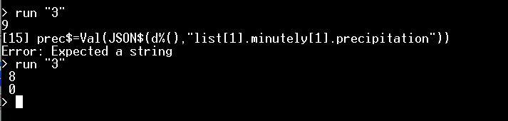

lew247
Joined: 23/12/2015
Posts: 1709
Posted: 09:55am 27 Nov 2020
I got nowhere with the above so I tried something new again
Can anyone tell me why is returns an INTEGER and not a STRING? AND if the result what it's showing is correct
You can see where I tried it as a STRING and the result is below
'prec$ = "9"
'print prec$
prec = 8
print prec
system "wget -q -O- "+q$+"https://api.openweathermap.org/data/2.5/onecall?lat=53.43&lon=-2.10&units=metric&exclude=current,hourly,daily&appid=0e661c0eb78b1f4b28419346ab6159db"+q$,d()
'prec$=val(JSON$(d(),"list[1].minutely[1].precipitation"))
prec=val(JSON$(d(),"list[1].minutely[1].precipitation"))
'longstring print d()
'if prec$ = "0" then icond$ = "null"
'print prec$
print prec
I need to know why it's doing it so I can have some hope of getting the other one to parse
This is longstring print d()
  Quote  {"lat":53.43,"lon":-2.1,"timezone":"Europe/London","timezone_offset":0,"minutely":[{"dt":1606469220,"precipitation":0},{"dt":1606469280,"precipitation":0},{"dt":1606469340,"precipitation":0},{"dt":1606469400,"precipitation":0},{"dt":1606469460,"precipitation":0},{"dt":1606469520,"precipitation":0},{"dt":1606469580,"precipitation":0},{"dt":1606469640,"precipitation":0},{"dt":1606469700,"precipitation":0},{"dt":1606469760,"precipitation":0},{"dt":1606469820,"precipitation":0},{"dt":1606469880,"precipitation":0},{"dt":1606469940,"precipitation":0},{"dt":1606470000,"precipitation":0},{"dt":1606470060,"precipitation":0},{"dt":1606470120,"precipitation":0},{"dt":1606470180,"precipitation":0},{"dt":1606470240,"precipitation":0},{"dt":1606470300,"precipitation":0},{"dt":1606470360,"precipitation":0},{"dt":1606470420,"precipitation":0},{"dt":1606470480,"precipitation":0},{"dt":1606470540,"precipitation":0},{"dt":1606470600,"precipitation":0},{"dt":1606470660,"precipitation":0},{"dt":1606470720,"precipitation":0},{"dt":1606470780,"precipitation":0},{"dt":1606470840,"precipitation":0},{"dt":1606470900,"precipitation":0},{"dt":1606470960,"precipitation":0},{"dt":1606471020,"precipitation":0},{"dt":1606471080,"precipitation":0},{"dt":1606471140,"precipitation":0},{"dt":1606471200,"precipitation":0},{"dt":1606471260,"precipitation":0},{"dt":1606471320,"precipitation":0},{"dt":1606471380,"precipitation":0},{"dt":1606471440,"precipitation":0},{"dt":1606471500,"precipitation":0},{"dt":1606471560,"precipitation":0},{"dt":1606471620,"precipitation":0},{"dt":1606471680,"precipitation":0},{"dt":1606471740,"precipitation":0},{"dt":1606471800,"precipitation":0},{"dt":1606471860,"precipitation":0},{"dt":1606471920,"precipitation":0},{"dt":1606471980,"precipitation":0},{"dt":1606472040,"precipitation":0},{"dt":1606472100,"precipitation":0},{"dt":1606472160,"precipitation":0},{"dt":1606472220,"precipitation":0},{"dt":1606472280,"precipitation":0},{"dt":1606472340,"precipitation":0},{"dt":1606472400,"precipitation":0},{"dt":1606472460,"precipitation":0},{"dt":1606472520,"precipitation":0},{"dt":1606472580,"precipitation":0},{"dt":1606472640,"precipitation":0},{"dt":1606472700,"precipitation":0},{"dt":1606472760,"precipitation":0},{"dt":1606472820,"precipitation":0}],"alerts":[{"sender_name":"Go to UK Met Office","event":"Yellow Fog Warning","start":1606420800,"end":1606478400,"description":"ches may lead to some travel disruption. Slower journey times with delays to bus and train services possible. There is a chance of delays or cancellations to flights"}]}
EDIT:
I also tried  prec=val(JSON$(d(),"minutely[1].precipitation")) and
prec$=val(JSON$(d(),"minutely[1].precipitation"))
Edited 2020-11-27 20:01 by lew247
Posts: 4386
Posted: 10:34am 27 Nov 2020
Instead of using VAL() what happens if you
PRINT JSON$(d(),"list[1].minutely[1].precipitation")
It may be (*) it's not a string, in which case VAL() would give the error it does.
* i.e. almost certainly
lew247
Joined: 23/12/2015
Posts: 1709
Posted: 08:55pm 28 Nov 2020
It was something really stupid
I had to change one of the returned values from Integer to Float
This one (Hopefully) should be a lot easier
