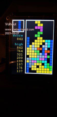

Just to prove I can do it, I wrote a tetris game for the Armmite F4.
The game is not finished, but it is playable.
The game plays on the ArmmiteF4 LCD, but is in this phase controlled from the PC terminal.
A move left, S move right, H rotate piece, <space> move down.
There is an anonymous high score list
The code needs cleanup, and makes use of goto and gosub a lot (sorry Geoff, MMBasic can do so much better). At least I dropped the line numbers...hihi.
Here is the current code:

many many thanks Volhout,
i like Tetris !!!.
the keypad control is suboptimal. but it looks very good.. and....  tetris is nothing without a big sound ( i remember my "AMIGA" time )
many thanks Ron

Hi RonnS,
I actually posted this tetris version with the intention to archive it, and not continue developing. The proof was given, I could write tetris.
But your response changed my mindset. I will improve the game with your suggestions.
By the way: keyboard controls sub optimal: what do you suggest as best keyboard controls (the Amiga ones ?) I am open to suggestions.
I have converted the old gameboy soundtrack to 8 bit WAV, so I can addi it to the game. The moment I played the soundtrack, old memories came back. Yes...sound is needed.
Posts: 6199
Posted: 07:52pm 01 Aug 2020

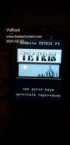

New version with sound (at pins PA4 and PA5) and non volatile highscore list
The sound is played from a file called "tet16cut.wav" that I will add to the zip
once the game is finished.
All that is needed now is more logical controls (RonnS ?) and intro screen.
And some small changes (the T piece is missing).
I ran into some issue with MMBasic with SD card files.
At the commandline you can open a file on the SD card for outputs as #1 and close it. Then open the file again for input as #1 and close it.
If you do this in the program you get an "file already open" error.
I had to re-open the file inside the MMBasic program as #2...????
I was just reminded by my wife that there where multiple tunes to choose from in the original gameboy tetris... so there is more to do...

I finally go time to finalize the game. I have made several changes from the earier versions, although the heart remains the same.
- changed the LCD to portait more
- added the intro screen, derived from the original game boy screen
- added the music from the original game boy
- added the 7'th piece (the "T" piece was missing)
- changed the controls to the arrow keys
It is running on the new 5.07 version beta 1
when checking the code, please understand that there is still a heritage
from the original controls, that where based on characters.
For now it is finished (terminal keyboard controls) but when I change it into
a stand alone game, there will be control buttons on the GPIO pins of the F4
The intro screen
The playfield
The ZIP containing the program, intro screen, and music is below
tetris_F4.zip
Happy playing....
Edited 2021-02-27 04:30 by Volhout
