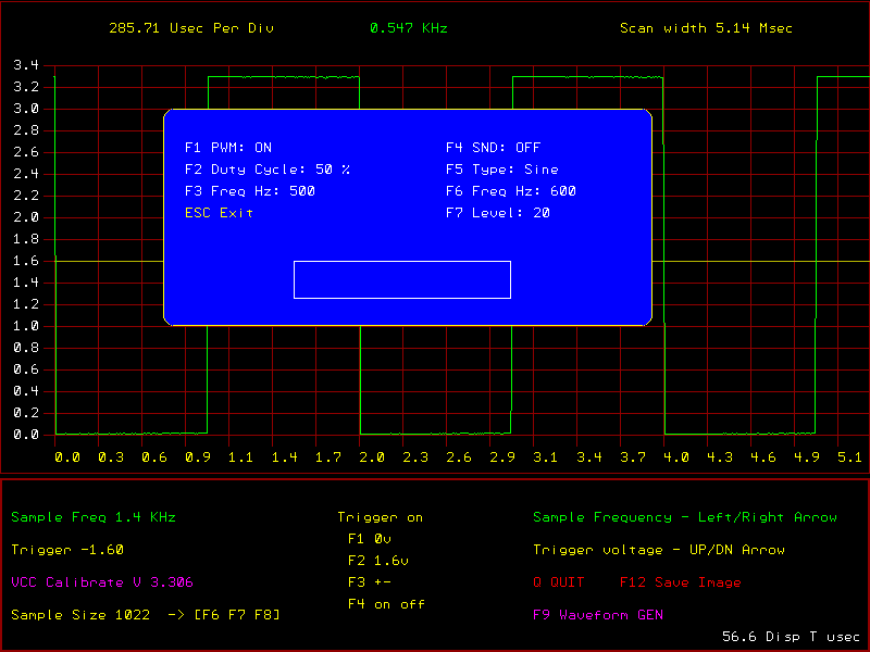

I've added a simple Waveform Generator to the CRO using the onboard PWM and DAC.
Just makes it easy to quickly setup some simple wave forms.
For displaying alternating waveforms from the DAC or other source, simply connect two 18k resistors to the input pin 7, one resistor connects to ground, the other connects to 3.3v, couple the input with a capacitor, value depends on input frequency but really for the purpose of playing around, anything from 100nf to 10uf would do.
NOTE: Observe the 3.3v input limit on the analogue inputs.
AudioCRO.ZIP

Is there avantage to PWM over PLAY SOUND ?

PWM is exactly that, pulse width modulation, a series of pulses at X frequency and of varying duty cycle as a % of the whole. Play sound uses the DAC and has implemented code to produce 5 basic waveforms. Other complex waveforms can be created using the sound DAC. The focus of this Audio CRO was on using the standard CMM2 functions and procedures. Play Sound is limited to 20KHz where as the PWM interface is up to 24MHz.

The requirements of a ADC with respect "accurate" waveform capture with increasing frequency is for another thread, however in simple terms, the ADC in the CMM2 will display a 50kHZ waveform, FFT transformation of the sample will show the correct frequency past 100kHZ. How you process and visualize the sample data is up to you.
