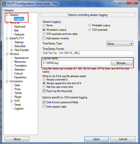

Hiya.
I am aware of Minicom and PUTTY - are there any others?
I am looking for one that can log anything received on the serial port, to a text file for examination later.  Not sure if Minicom or PUTTY can do that already - I am off to research that aspect of both of those programs now.

in putty...
