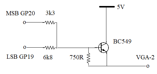

Re VGA current requirement.
The Sync. pins are high Z so none there and the two greens add up to 9ma, same as R & B. 27ma total to the monitor for a full white screen. If memory serves, the total continuous current for all outputs needs to be less than 50ma. A limitation of the Pico.

  phil99 said  Re VGA current requirement.
fair enough - although even at 27mA, that is still half of your I/O power budget gone. i'd be interested to hear what the actual measured consumption is, ie first driving a real monitor, then with the pico's pins (GP16-GP21) left open-circuit.

Posts: 3348
Posted: 04:22am 23 Jan 2022
That 27ma can be saved from 3.3V supply and Pico output budget by using 3 NPN emitter followers with collectors to 5V for the VGA. The green resistor network will need recalculating. Emitter direct to VGA-G pin and a resistor base to emitter as a load for the network . The emitter resistors for R & B = 220R.
Re post when I sort out the values.
Edit
I think this will be adequate (untested). The values can be adjusted for improved balance by trial and error.
Edited 2022-01-23 15:25 by phil99
