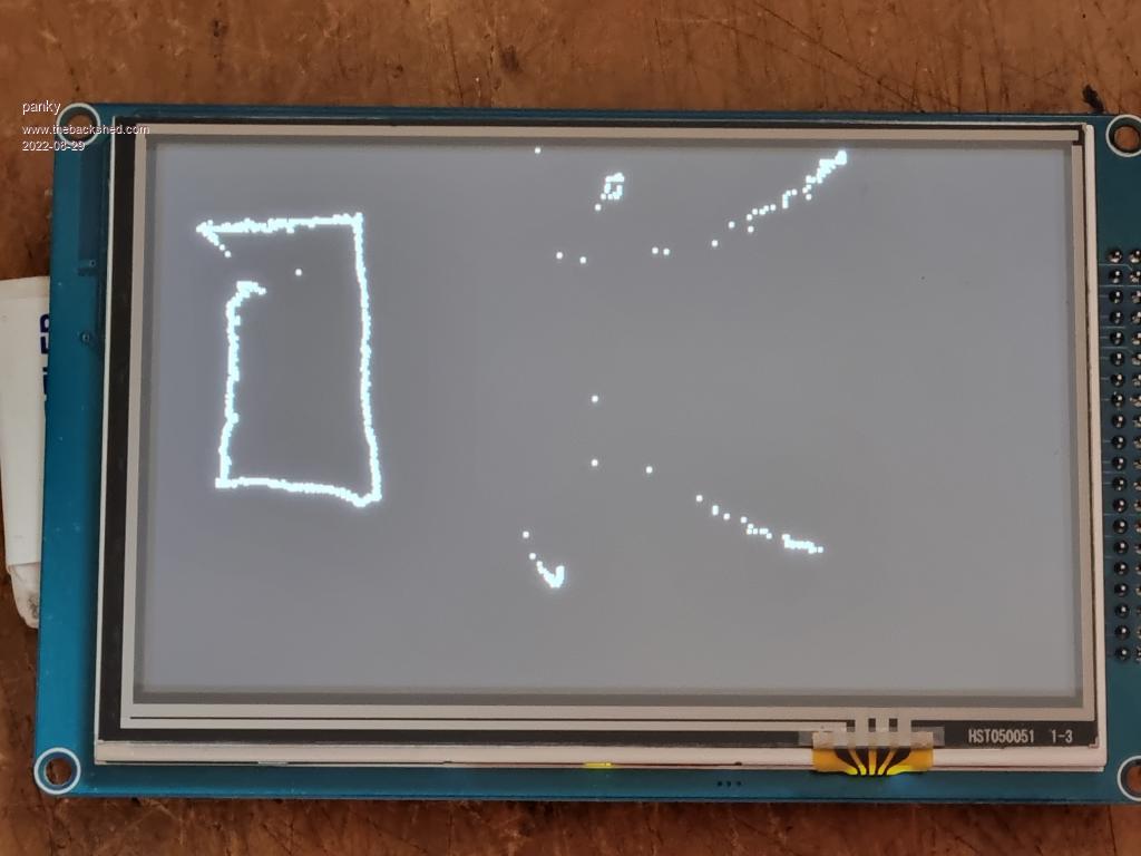

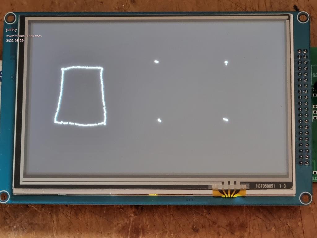

Picomite running MMBasic 5.07.05b17 with SSD1963_5 display.
All versions prior to b17 touch worked and I could calibrate correctly. GUI TEST TOUCH gave accurate display.
5.07.05b15 GUI TEST - draw a shape then 4 dots
With b17, same hardware, same display, I am unable to calibrate because of wild errors (eg. x=-243 y=29, x-37 y=-77 and so forth). Manually enter calibrate values is accepted.
Have tested with 2 different Picomites, 2 different SSD1963_5 displays - everything works fine with 5.07.05b15 and prior versions. Stylus used was as supplied with display (fault still the same regardless of stylus type used).
SSD1963_5 also tested on MMBasic on a Micromite + which also works correctly.
With 5.07.05b17, when running GUI TEST TOUCH, if I touch any spot on the display I get a cluster of dots (dozens) around the touch point that seem to smear off to one side.
5.07.05b17 GUI TEST - draw a shape then 4 dots
Any advice appreciated.
Doug.

Similar effect on ILI9488 3.5", though not quite as bad. Mostly near the edges of the screen. I had assumed it was just because it was cheap.

I've just confirmed that GUI TEST TOUCH also gives strange artefacts (ie a single touch gives a short line and several dots, just like Doug's second picture).

Please wait for next beta or revert to b15. I increased the SPI speed for touch in b16. works fine for me but apparently not for everyone

b15 had an SPI touch speed of 500000 (around line 377-ish of SPI-LCD.h) and looking at the logic analyser trace I measured 3 clock cycles (the acquisition time of the XPT2046) as 6.05uSec.
For b17, as Peter said, the SPItouch speed has now been set to 5000000 (a 10 fold increase) and measures 620nS on the logic analyser for the 3 clock cycles.
The significance is that the XPT2046 needs 3 clock cycles for its acquistion phase and has a spec of 1.5uS as the minimum acquisition time - b17 is clearly under this and my (not very educated) guess is that this will result in erratic readings on some but not necessarily all units.

@johns, 18 works a treat.
