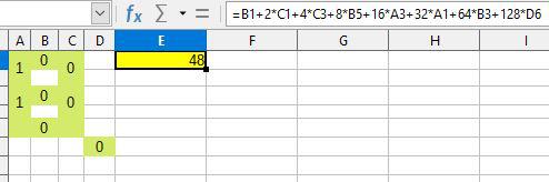

and with a little imagination, you'll also get Test:
ok for M  and W you will need 2 Digits
a little helper for Excel or Libre Office
7segment.zip
Edited 2022-11-06 19:46 by Martin H.

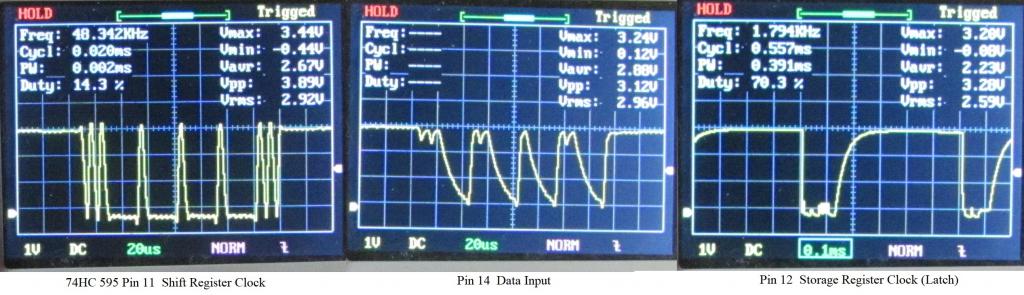

Posted: 12:04pm 07 Nov 2022

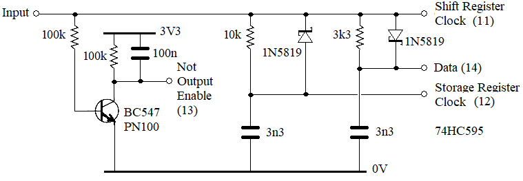

Another way to drive these displays, or any SN74HC595N chips and save a pin or two.
SPI requires a Rx pin even though it isn't needed here and a fourth pin is used for the storage register clock.
And a fifth pin for CS if SPI is shared.
This circuit provides the storage register clock when the shift register clock pauses between transmissions.
Any two PicoMite pins can be used. HC595 pins 16 & 10 to 3V3, 8 & 13 to 0V.

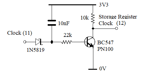

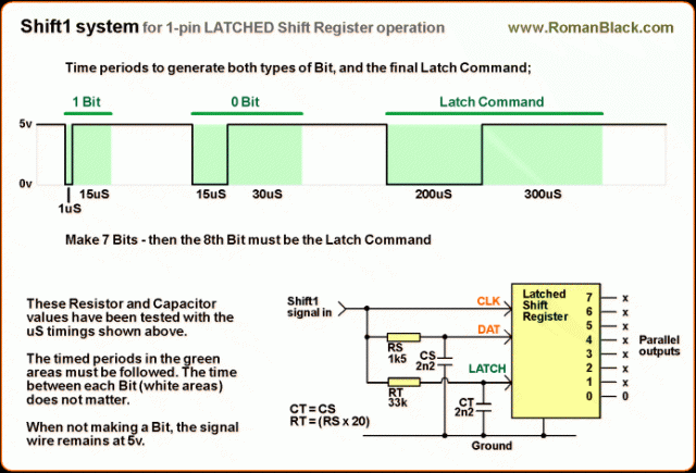

After devising a method of also getting the shift-register clock from pulse width modulating the data I found it had been done better before by getting the data from the PW modulated clock..
See here:- www.RomanBlack.com/shift1.htm
His method for getting the latch pulse sacrifices a data bit. Adding one diode fixes that and no longer needs a separate latch pulse (the separate latch pulse uses a data bit).
Adding another diode to the data line allows it to run faster, by instantly recharging the timing capacitor.
These are the results.

Data Pin 14 - 3n3 to gnd, 3k3 to CK, diode cathode, anode to CK - Pin 11
Latch Pin 12 3n3 to gnd, 10k to CK, diode anode, cathode to CK  - Pin 11
Another EDIT
When first powered up there can be some random output. This circuit holds the Not Output Enable pin (13) high until you have initialized the chips with all low, all high or whatever startup state you require.
Here is some test code for a 4 digit display. HC595 pins 16 & 10 to 3V3, 8 to 0V.

The Bitstream times are chosen to suit the R-C values in the diagram.

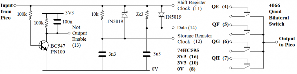

The Pico doesn't have many ADC input pins and the PicoMiteVGA with all extras fitted doesn't have all that many pins left. This gives you another 3 analogue (or digital) inputs and 3 more digital outputs.
In this example the 74HC595's 4 low outputs expand one Pico output and the upper 4 outputs drive a CD4066 quad analogue switch IC to expand one analogue input.
The 4 analogue inputs are read one at a time and displayed via LEDs as integer values on the 4 low outputs. Not useful just a hint at what can be done.
Connect 4066 input 1 to 0V, !k from 1 to 2, 1k from 2 to 3, 1k from 3 to 4 and 4 to 3V3 and the LEDs will light in sequence.
74HC595
