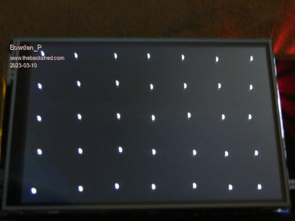

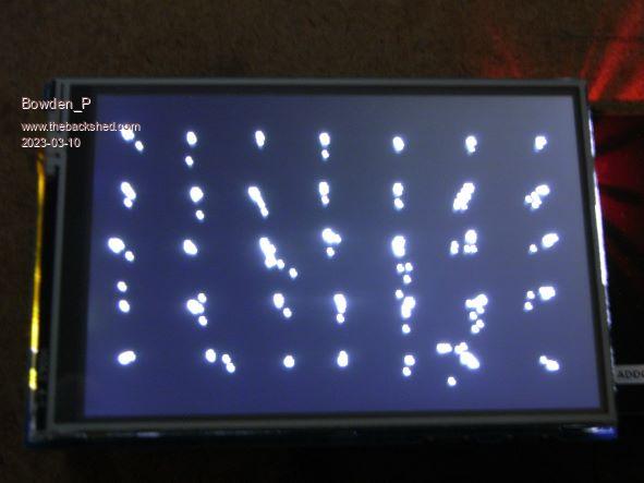

Both exhibit screen splatter when the "GUI TEST TOUCH" test is run.
This is a typical result when making a 7 x 5 array of touched points :-
Most - but not all - of the rogue pixels appear on the touch release.
Repeating "GUI CALIBRATE" doesn't appear to change this.

I get this result :-
Just wondering if my screens are at fault. Has anyone else seen this ?

Not sure what the issue is. Your test looks pretty much perfect. GUI TEST TOUCH doesn't purport to be anything more than a very simple test that touch is working and the line tracks the stylus when it is kept in contact and moved. It does not do anything to remove release artefacts

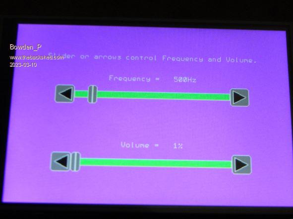

I am experimenting with controlling frequency and output level of an oscillator using 2 slider-like graphics, but the jitter I get is causing very erratic behaviour, akin to the GUI TEST TOUCH response. ( I also hope to use some Advanced Graphics features.)
I have based these graphics on one used in a previous project using a Micromite v2 to control a servo, which worked very successfully, so hoped to do the same here.

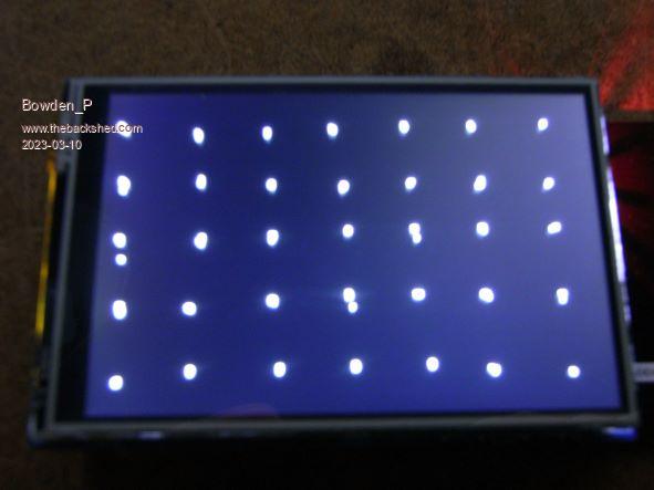

Please try the attached and let me know if better

Wow - that's quite an improvement, as below!!
Thank you very much! There are 5 points showing a second point plotted, but they are nevertheless very close to the original.
I have also tried my slider graphics, which now work very much better too!
May I ask what the fix was?
