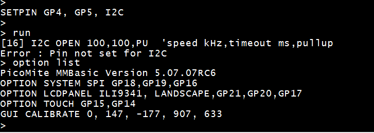

I've just come bqack to Picomite after a break and I've been scratching my head all morning
I cannot get i2c to work
SETPIN GP4, GP5, I2C
> run
[16] I2C OPEN 100,100,PU  'speed kHz,timeout ms,pullup
Error : Pin not set for I2C
This is my options
Anyone got any ideas how to fix it?
Posts: 11999
Posted: 11:42am 25 Apr 2023
The setpin needs to be in the program

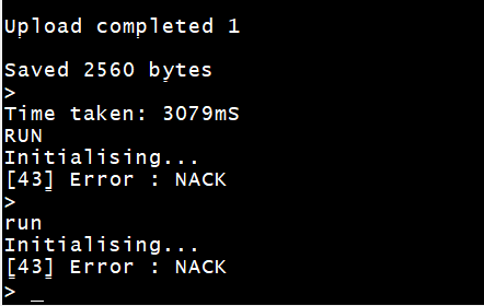

Thanks Peter, I did try that first
This is the program

This is what I get when I run it
Edit: I have buzzed out the connections and they are all correct
Edited 2023-04-25 21:50 by lew247
