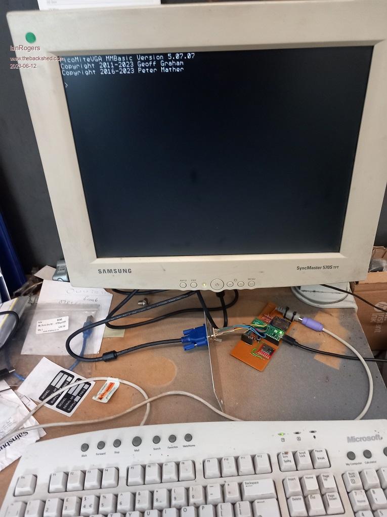

Posted: 12:14pm 12 Jun 2023
Done...
Just the sound to do.. Need to connect the RTC as well but running none the less
In colour as well.

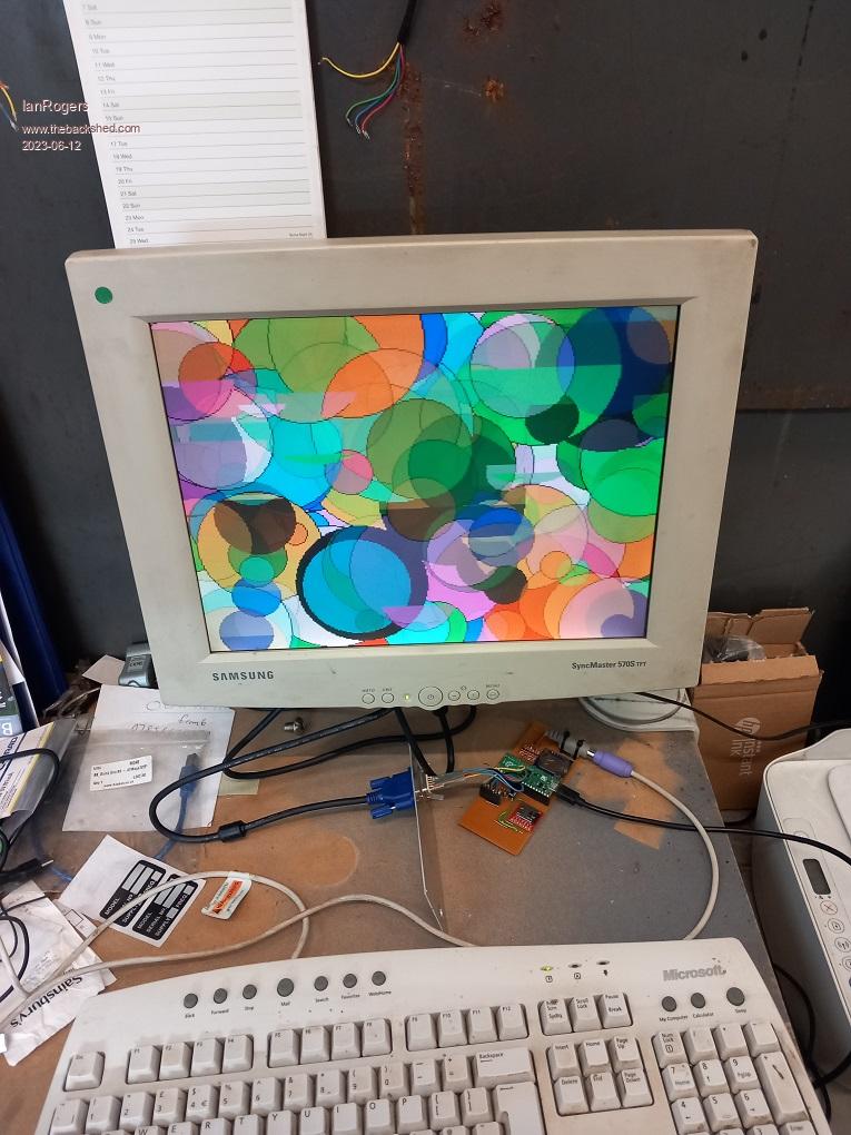

Posted: 01:25pm 12 Jun 2023
LOL just for your entertainment..  I typed in GUI TEST LCDPANEL Something happened but  not what I was expecting.. Then the sun rose.. Mode 1 is mono  Mode 2 worked a bit better!!
Posts: 9030
Posted: 04:51pm 12 Jun 2023
Interesting. I didn't know that GUI TEST LCDPANEL worked on VGA displays - and LCD panels don't have Mode 1 and Mode 2 ...
Are you trying to get me even more confused than I usually am? (It's difficult - being confused is normality for me. :) )
Oh - and don't worry - decoding SPI connections is a pain until you get used to it. It was only just after I'd got used to MISO and MOSI that it became politically incorrect to use them, even though they are completely logical and there is no meaningful substitute.
IanRogers
Joined: 09/12/2022
Posts: 152
Posted: 05:31pm 12 Jun 2023
Confused????  Well  CLS rgb(yellow)  in mode 1 turns the screen yellow. you can clear the screen in any colour in mode 1.
But its a mono mode...go figure..GUI test lcdpanel in mode 1 draws white circles until no more room is to be had.  Mode 2 does it properly.
