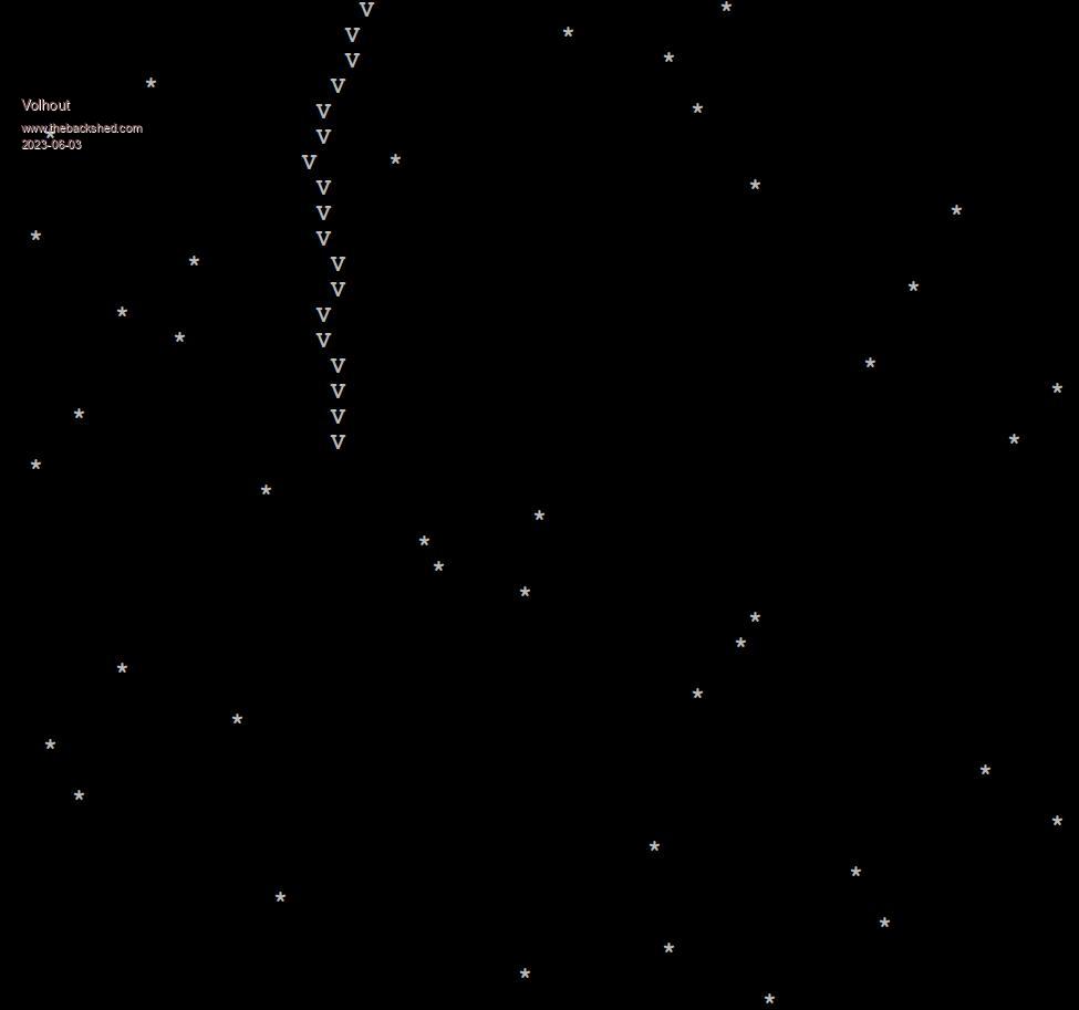

Try to maneuver your spaceship "V" between the stars "*". For VGA Picomite in mode 1. You start your journey on the left side of the screen. Use left and right arrow to maneuver. Start with right arrow, or you will be flying in another universe...
1 Text 8*c,84,"V":Pause 99:b=Asc(Inkey$):c=c+(b=131)-(b=130):a%=80*Rnd():Print @(8*a%,468)"*":If Pixel(8*c+4,89)=0 Then 1
This version works for all picomites through terminal (tested on Putty). It is slightly longer.
1 Print @(8*c,84)"V":Pause 99:b=Asc(Inkey$):c=c+(b=131)-(b=130):a%=80*Rnd():Print @(8*a%,468)"*":If Pixel(8*c+4,89)=0 Then 1
You can shrink the game to an absolute minimum, but then you exit the game with an error. PicomiteVGA only.
1 Text 8*c,84,"V":Pause 99:b=Asc(Inkey$):c=c+(b=131)-(b=130):a%=80*Rnd():Print @(8*a%,468)"*":GoTo Pixel(8*c+4,89)+1
Happy playing....
P.S. the trick is to PRINT a new "*"<CR> at the bottom of the screen, so it starts to scroll. TEXT will not do this.
Edited 2023-06-03 17:42 by Volhout

  Volhout said  A complete game in one line......
looks like my very first "game" on my 1k ZX81
'no comment

  Volhout said  the PIXEL command does not exist in other MMBasic's. So ... VGA only..
PIXEL command exists in Picomite, Micromite, Webmite, CMM2, F4, MMB4W (just the 'mite manuals I had open).
Posts: 6036
Posted: 11:57am 05 Jun 2023
  lizby said  Thanks for posting those one-liners. They've been fun to try.
PIXEL command exists in all Picomite.
But the game relies on using the print "*"<CR> function on the active screen to scroll the screen.
In Webmite you can create a virtual screen, but can write only using the TEXT command. The PRINT (that causes the screen to scroll) does not work on the virtual screen in webmite.
This may be similar for the LCD screens. Maybe if you do something with OPTION CONSOLE it may...
For now this one-liner game only works on VGApicomite. Sorry...
