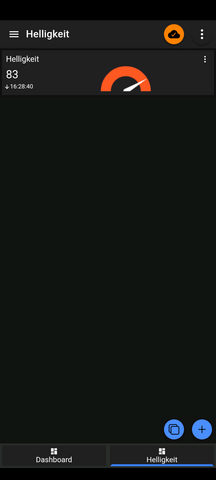

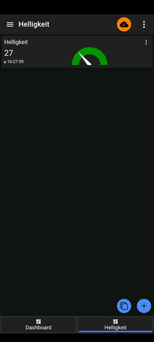

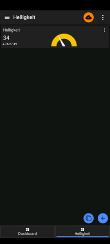

andreas
Joined: 07/12/2020
Posts: 226
Posted: 03:12pm 02 Jun 2023
With the latest WebMiteV5.07.08b2 it works and values can be made visible using IoT MQTT panel:)
-andreas
