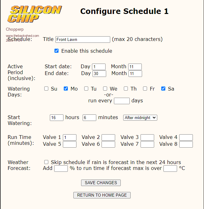

I've just started playing with this on a bare bones 2040 W today.
On setting the watering days, the prescribed timer does not appear to be get set for the current day [Mo] unless [Sa] is selected as well, in fact selecting just [Sa] will set the timer for the set time for today & run at that time. (Set time > than current time). In all other cases, the auto refresh timer gets set to midnight.
Selecting [1] for every day works OK.
Am I missing something? Just wondering.

Hi Brian,
I may be wrong (yet again) but the system knows that today is Saturday so it won't run today's schedule on Monday.
Is that it? (if so we can have a good laugh together)

OK.......for some unknown reason, I thought it was Monday. Not feeling too good today. Should be out elsewhere instead of being at home so got confused.

OK, after yesterday's embarrassment of forgetting what day of the week it was (today is Sunday), I'm happy to report that the bare bones "W" works as advertised for the basic stuff on the Watering System Controller prog.
With the weather forecast of 96% rain & it is actually raining (first good wet stuff for a while), that tick box worked as well.
