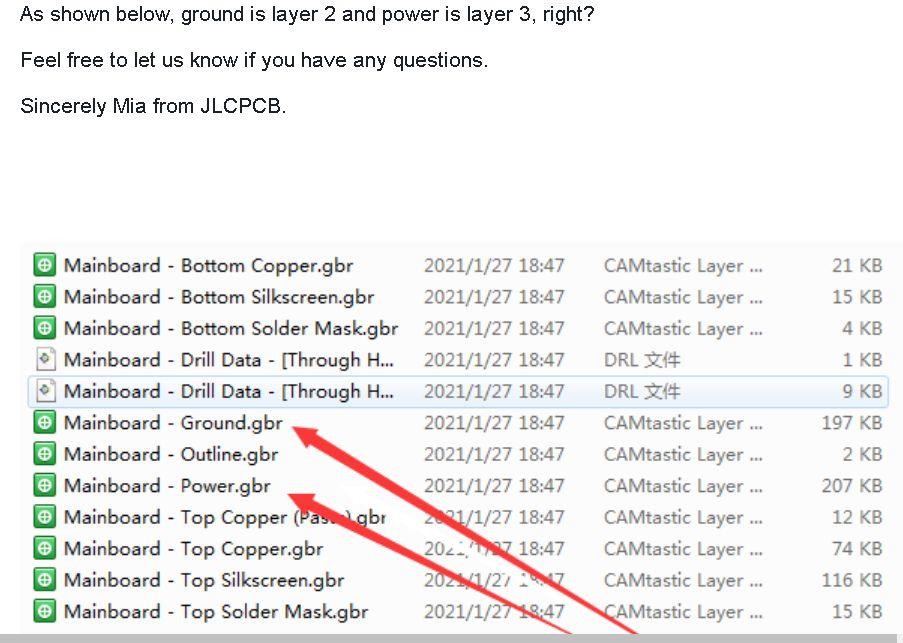

I've never been asked this before, even though I got heaps of CMM2 boards from JLC prior to the virus, but this tech wants to know about the ground and power plane layers - Peter, please advise....

top,ground,power,bottom is correct

That list is almost as if it's for a multi-layer board. I'd have expected "Top Copper" and "Bottom Copper" to be the layers populated. Perhaps it is? I don't know.

The G2 is a four-layer, from what I can see.
Top and Bottom copper are the outside top and bottom layers, and "Ground" and "Power" are internal ground and power plane layers, so JLC were just wanting to make sure they got the power and ground layers the right way around.
