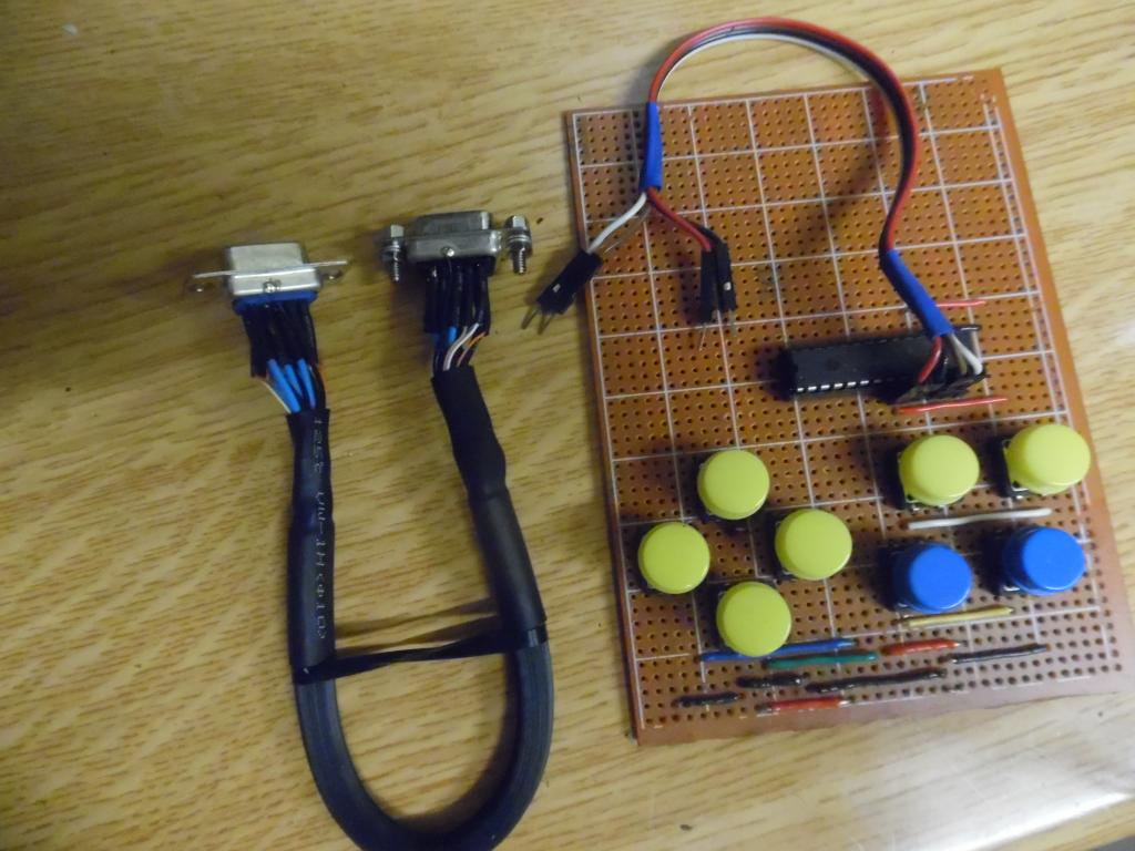

It's just that if I use a USB Picomite I have a USB keyboard plugged in already, & and it has an internal hub, with 3 USB sockets along the back, so it would be very easy to use. I already have a Wii controller, for which I made an extension cable with connector on the end to go to the connector along the back of the Game*Mite, sounds like I'll have to try bringing out the same connections & use that, I was hoping to not have to bring out more connections. :-(

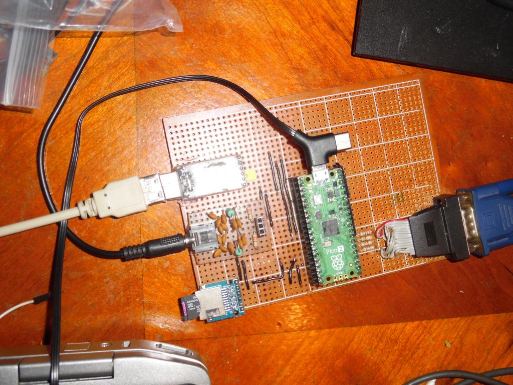

picomite 2040,vga 2040,usb pico2040, usb vga 2o40 and all pico2 versions.
I lost the thread'
the usb serial to ttl is a male socket and plugging into a usb2male to female lead unreliable.
looking for female usb serial to ttl
I only got bread board vga pico. solder stripboard tomorrow
got vga sockets and gonna use mcp23017 i2c 16 pin expander for key input.
the usb vga is nice but serial usb to ttl is 5v power and all my connections fail.
thing is do I use a keyboard in a program? no. so why bother with usb ?
gonna do a nice stripboard normal vga tomorrow. got a pack of 5 inductors for sound filter,3 left. veecad handy. I'll be using pico blue usb c. seem ok
these vga sockets are <£2 for 2

the female to male serial usb to ttl is a pain.drops out and tried a few

v13 working if I comment playmod. Twills less joy-error pc3 or begin with p. thanks anyway, I'll retry.
usb vga pico2... so interesting 2040 stuff on pico2
with usb then 5v from serial ttl to pin 40 5v sys. I stuck it into socket 40 not soldered hence my problems. soldered and stable.. no windows dinky ding dinky dong.
haven't tried i2c buttons cos ship action is too slow

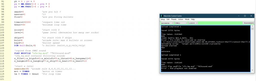

> run
[105] Play modfile "sfx-bg.mod" '"RISsound.mod"
Error : Mod playback not enabled
Dunno what's wrong. I did have sound with 2040. maybe pico2 problem.
Graphics are great. this is pico2 usb vga.. someone's got to test it. regards, stan

Stan, I think you must have forgotten, if you are going to use PLAY MOD then you have always had to preallocate some of the flash to it, e.g. at the prompt:
OPTION MODBUFF ENABLE 192
WARNING! this will erase the contents of A: drive.
Good luck,
Posts: 2807
Posted: 04:58pm 01 Sep 2024
This will erase everything in flash including the A: drive - are you sure (Y/N) ?
Error : Could not find the file
> UK USB Keyboard Connected on channel 1
> Generic Gamepad Connected on channel 2
> run
> option list
PicoMiteVGA MMBasic USB Edition  6.00.00b2
OPTION AUTORUN  ON
OPTION FLASH SIZE 4194304
OPTION COLOURCODE ON
OPTION KEYBOARD UK
OPTION CPUSPEED (KHz) 378000
OPTION SDCARD GP13, GP10, GP11, GP12
OPTION AUDIO GP0,GP1', ON PWM CHANNEL 0
> C:\Users\stanley555\Downloads\2024-08-30_055145_rocks13\rocks13.bas
Uploading using:  'target port\COM11:115200 s\picomite
Upload started
NEW
autosave
Upload completed 1
Saved 22332 bytes
Time taken: 20525mS
RUN
it was   play modfile "b:\sfx-bg.mod" '"RISsound.mod"
now it plays and sound.. got level 3
