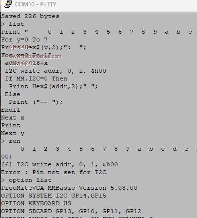

I'm using a PiPicoMite03 board from Land Boards.  I'm using the MMBasicVGA latest version from Geoff's site.  Everything is working well except RTC.
I configured 'option system i2c gp14,gp15' which resets the board.  There was a note to use 'option system i2c2 gp14,gp15' in the PiPicoMite03 documentation but I get an error when I try that.
The issue is the RTC doesn't respond.  I've tried two rtc boards and neither one responds.  Am I setting up something wrong?  The module is getting power, ground and the SDA and SCK lines show activity on the scope when I send 'rtc gettime'.  Both modules are DS1307 devices.  What is gp5 (DS) used for?  It's connected to the module but doesn't show any activity.  I'm probably missing something but not sure what.  What's the I2C address MMBasic is putting out there, if anyone knows.

lizby, thanks for the test app.  It appears I have two DS1307 boards that aren't functioning.  I find a ds3231 board is working well, although it's form factor won't work as well as the tiny I2C 1307 boards.  I've ordered two more boards from Amazon and will try again.
Again, thanks for the useful app.  I tried it but it doesn't work
in I2c write line, error : Pin not set for I2C

  dpcons said   useful app.  I tried it but it doesn't work
If you have set OPTION SYSTEM I2C connect the module to the pins specified there (option List) and don't set I2C in the program.
Eg. change the start to this:-
' i2cdetect like program
' Set Pins!
' SetPin gp0, gp1, I2C
' Open first I2C
' I2C open 100, 200

Phil99 and Lizby: I've done as you said.  I commented out the SetPin and I2C open calls.  Still doesn't work for me.  Error returned on the write.  I'm using the PicomiteVGA code, very latest. I also tried it on another Pico with Webmite software installed.  Tried it with the code you supplied. Setpin gp0, gp1, I2C returns illegal configuration.  I then used Option System I2C gp14, gp15.  System rebooted.  Tried same code except commented out the two first lines.  Same error on write as with the picomiteVGA code.
Everything on the board works now.  I've tried 4 different DS1307 tiny I2C RTC
modules and none of them work. I think there's an issue.  All the DS3231 modules work fine.  Beats me. Any, thanks for your responses.

Whilst system I2C will work on I2C or I2C2 pins, I'm pretty sure the program above won't work because from MMBasic you still have to specify the correct port, if Dpcons is specifying GP14/GP15 as system I2C then he will need to specify I2C2 to access the port in a program. Been caught out by this in the past...
Now where is that DS1307...

Agreed that to use the standard RTC commands you are correct, option system I2C can use I2C or I2C2 pins and no need to specify which.
However, if you want to access the system I2C port from MMBasic, the correct port needs to be addressed. As you mention, no need to open the port as it's already open, but if you use I2C2 pins as system I2C, you'll need to access it as I2C2.
As the PiPicomite03 uses GP14/GP15 for the RTC I2C, the above program will only work if the line I2C write addr,0,1,&h00 is changed to I2C2 write addr,0,1,&h00
Just tried this on a DS1307 on V05.08.00 and it is still the same as previous versions.
Lyle.

Mozzie, you are correct on the I2C2 modification.  App now works.
Thanks much.

Instead you can use minimalist method at the console command line.
Edit to suit then copy & paste the relevant lines to the command line.
> 'SDA pin = GP 4 and SCL pin = GP 5 on channel 1
> setpin gp4,gp5,I2C : I2C open 100,200
> for addr=0 to 127: I2C write addr,0,1,0:If not MM.I2C Then :?addr,"&h"hex$(addr):endif:next
81     &h51
87     &h57
> 'Using System I2C on channel 2
> for addr=0 to 127: I2C2 write addr,0,1,0:If not MM.I2C Then :?addr,"&h"hex$(addr):endif:next
41     &h29
56     &h38
83     &h53
104    &h68
