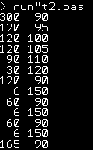

This code prints out 2 columns of zeros, (it is the times and cadence for the British cycling 20 minute warm up) white space is added to align times with cadence when the screen width is set just right, the "DIM" is all on one line.
Why aren't the values being assigned to the array?
DIM integer BS20min (13,2) (300,120,120,120,90 ,30 ,120,6  ,60 ,6  ,60,6  ,165,
                           90, 95, 100,105,110,120,90, 150,90, 150,90,150,90)
for x = 0 to 12
for y = 0 to 1
print BS20min (x,y);
print " ";
next y
print   'new line
next x

Missing = sign sorted!

I made some changes to your code
option explicit
option base 0
dim BS20min%(12,1)=(300,120,120,120,90,30,120,6,60,6,60,6,165,  90,95,100,105,110,120,90,150,90,150,90,150,90)
dim x%, y%
for x% = 0 to 12
   for y% = 0 to 1
       print right$(space$(3) + str$(BS20min%(x%, y%)), 3) + " ";
   next y%
   print
next x%
output:
