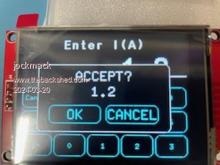

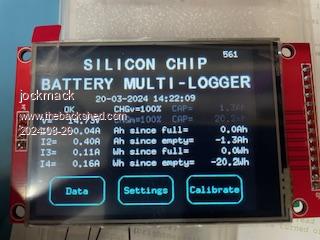

Hello to everyone, I am new to the group but have a problem with a project I am unsure of how to solve.
I recently built the SC project "Battery multi logger".
Its based on micromite type design using PIC32MX170, it uses AD7192 four channel 24 bit ADC with SPI interface. A pic 16F1455 also provide USB to serial interface.

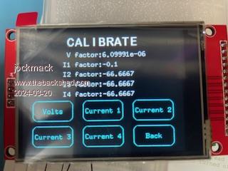

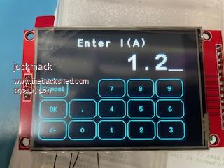

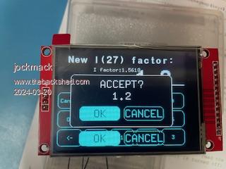

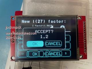

The problem is it works but I am unable to calibrate the current settings for the inputs. I have included some photos to show the interface on the LCD touchscreen ILI9341.
I was able to calibrate the volts OK and it is working fine but when trying to save any of the current values it appears to lock up the display. I don't believe the PIC is locked up as when the display is frozen I can still access the PIC and interrogate it via the USB  port and Tera term. Only a power cycle will clear the display.
I have reloaded the hex image as per Silicon Chip download but the behaviour was the same.
The images are in sequence, when you accept the value entered another OK Cancel buttons are displayed below the original OK Cancel buttons.Selecting OK locks up but Cancel will take you back to the calibration selection display.
The original basic code is as below.
I would expect there is no bugs as SC would have tested and I haven't seen any errata
or notes regarding this project.
One other anomaly I noticed was when initially setting up the touch screen (2.8"v1.2)buttons were mirror imaged as to the touch sensor, I did a GUI calibrate and it flipped the touch sensor but it did complain it with Warning: inaccurate calibration 0, 3937, 3855, -904, -544. original setting was 0, 192, 230, 908, 687.as per SC provided PIC32MX170.
If someone could point me to where I should look I would be grateful.
Jock

 DIM FLOAT I_CAL(5)
 I_CAL(1) = -1/(100*0.1) '0.1# shunt with x100 gain same as 10# resistor. 1V => 100mA, result in A
 I_CAL(2) = -1/0.015  'nominal 15m# shunt
 I_CAL(3) = -1/0.015  'nominal 15m# shunt
 I_CAL(4) = -1/0.015  'nominal 15m# shunt

SUB DO_I_CAL(I_NUM AS INTEGER)
 LOCAL I_ENTERED AS FLOAT
 LOCAL NEW_CAL AS FLOAT
 LOCAL ACTUAL_NOW AS FLOAT  'temp as this may change
 ACTUAL_NOW=abs(ACTUAL(I_NUM+1))
 IF ABS(ACTUAL_NOW) < 0.00001 THEN MessageBox("I TOO LOW","Check and retry") : EXIT SUB
 CLS(BG_COL)
 IF RAW_ACTUAL(1) < 800000 THEN MessageBox("INPUT V TOO LOW","Check and retry") : EXIT SUB
 I_ENTERED=NUMBERPAD("Enter I(A)")
 IF I_ENTERED < 0.000001 THEN EXIT SUB   'cancel
 NEW_CAL = I_ENTERED/ACTUAL_NOW
 TEXT 160,10,"New I("+STR$(I_NUM)+") factor:",CT,8,1,FG_COL,BG_COL
 TEXT 160,40,"I factor:",RT,1,1,FG_COL,BG_COL
 TEXT 160,40,STR$(NEW_CAL),LT,1,1,FG_COL,BG_COL
 IF OK_CANCEL_BUTTONS() > 0 THEN
   ''accept and store values
   I_CAL(I_NUM)=-NEW_CAL
   VAR SAVE I_CAL()
 ENDIF
END SUB

I have done some more investigation & it seems I am getting an out of bounds error.
This came up on Tera Term as I entered calibration data.
[675] I_CAL(I_NUM)=-NEW_CAL
Error: Index out of bounds
I will post more info if I find out why this is occurring.

SUB CALIBRATE_MENU
DRAW_CALIBRATE
DO
  SAMPLE_MANAGER
  BUTTON_PRESS=CheckButtonPress(0, 5)
  IF BUTTON_PRESS >= 0 THEN
    CheckButtonRelease(BUTTON_PRESS)
    IF BUTTON_PRESS = 0 THEN  'volts
      IF OK_CANCEL_BOX("ENSURE NO LOAD","ON TERMINALS")>0 THEN DO_V_CAL
      DRAW_CALIBRATE       'return
    ENDIF
    IF (BUTTON_PRESS >=1) AND (BUTTON_PRESS <=4) THEN  'I1
      DO_I_CAL(BUTTON_PRESS)
    ENDIF
    IF BUTTON_PRESS = 5 THEN EXIT DO
  ENDIF
LOOP
DRAW_MAIN
END SUB

Interestingly in the last 2 images in the original post, the heading at the top of the screen says: "New I(27) Factor:". It seems it has already got 27 as the index into I at the time this screen is displayed!

I have done some further testing and I(27) value appears to come from a button press on OK after selection of I value.
The value of I_CAL(I_NUM)=-1 right up until the OK is pressed.
Possibly from something in OK_Cancel_Buttons function?
I don't know how it's connected but that spurious "27" value is injected at that point.

In case it's relevant, 27 is the code for the (ASCII) Escape character.
Could it be from Cancel?

Thanks for the input JohnS, you're suggestion of ASCII escape character is probably correct.
In running the program on the backpack and stopping and interrogating the value of
Button_Press is equal to -1 for each of the 1 through 4 current buttons.
It changes to 27 after input of any value except zero and selecting OK but before OK
at the Select window.
This part of the code starting at Line 321 should input value of 1 through 4 but
doesn't appear to be so. It does work for volts though with a 0 value returned.
