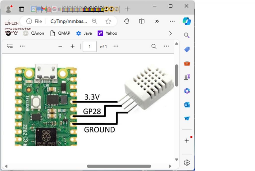

I just got a Pico-W in the mail and I figured I would load up the WebMite firmware and put the Humidity and Temperature web page code on it.   I got the web page to show on my browser but I'm getting 1000 for both Humidity and the Temperature.   And the documentation says that is what I will get if I don't have a DHT22 sensor connected.
I'm just curious.   Looking at the demo code it seems like the bit banging should be down on GP28 to match the circuit shown on the demo page.   Of course I tried that, but I'm still getting a temperature of 1000.
Does anybody have any ideas what I should check?    I'm wondering if I got sent a DHT-11 by accident?   Does anybody know if the initialization and command set are the same for the two parts?

Try increasing the pause to 2000. DHT sensors won't wake up if the pause is too short.
If this is on a breadboard check continuity from the Pico pins to all the DHT pins. Verify that you have 3.3V at the DHT pins. You may also need a pullup resistor, 3.3kΩ to 10kΩ.
See "Measuring Humidity and Temperature" in the manual.
A DHT22 command line test using whatever pin you have it connected to:-
Do :Device Humid GP28, t, h :? t, h :pause 2000 :loop
And for a DHT11:-
Do :Device Humid GP28, t, h, 1 :? t, h :pause 2000 :loop

Increasing the Pause to 2000 or 2500 doesn't help.   The connections have the pins of the Dupont wire soldered into the Pico-W.  The other side of the Dupont wires are female and go to the circuit board the Alleged DHT-22 is on.
I'll do the pull up next and see if that helps...
PS.  I messed around a little with:
The syntax is off.  I don't know what you intended.  I'm going to try that in a program instead of in immediate mode.

What firmware version are you running?
In later versions, BITBANG has been changed to DEVICE
DEVICE HUMID is the same as BITBANG HUMID
If you think it might be a DHT11, se the manual for command syntax
  Quote  DEVICE HUMID pin, tVar, hVar [,DHT11]
If the optional DHT11 parameter is set to 1 then the command will use device timings suitable for that device.
Using a pullup is strongly recommended.

Score!   Changing the GP15 to GP28 and adding the  ",1" to the end of the line made it work.   Even though I specifically ordered a DHT-22 they decided to send me a DHT-11.   Oh Well...   I got the demo working!!!!
Understood!   It looks like they have two surface mount resistors on the back side of the board.   So that is probably OK now that the web page returns meaningful values.
