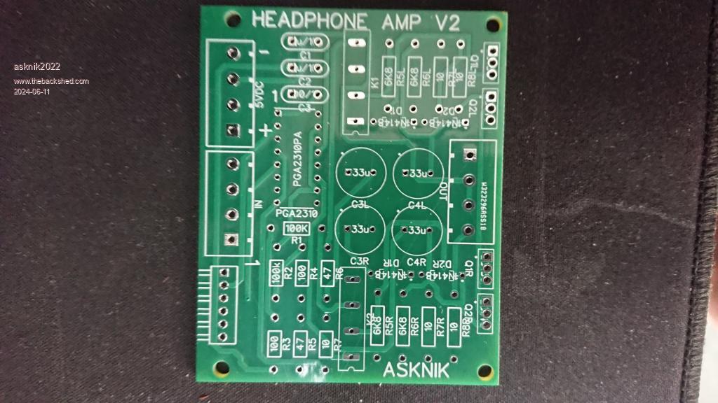

Is anybody interested in a Headphone amp  controlled by Digital Volume PGA2310 programmed via pi pico
I have cirucuit diagam and have pcbway currently making some boards for me.

Headphone Amp.pdf
Circuit diagram attached.

Where does the -5V come from? Does it need an extra supply?
asknik2022
Joined: 26/03/2022
Posts: 94
Posted: 04:17pm 03 Jun 2024
You need a +-5V split rail supply to power the analog side of the PGA2310 and Amp.
You need a 5V single rail supply (which can come from the Pico) Via the 6 Way connector which also handles the SPI from the Pico

Posted: 10:50am 11 Jun 2024
I now have the PCB's.
If anyone is interested and in the UK, I have a few to give away and can post but only if you are in the uk.
