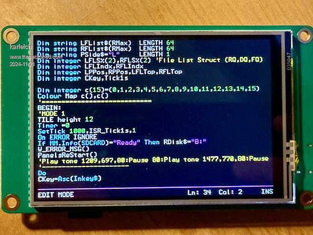

Hi,
I recently got a CrowPanel Pico display - a Pico 2040 with a 3.5" 480x320 TFT attached. Could not resist, was relatively inexpensive (19 €) and the display looked brilliant.
https://www.elecrow.com/wiki/CrowPanel_Pico_HMI_Display-3.5.html#resources-download
Just in case someone is interested in such a display, here are a few things I figured out. I used PicoMite MMBasic Version 6.00.00RC15 for testing and these options:
OPTION FLASH SIZE 8388608
OPTION LCDPANEL ILI9488, LANDSCAPE,GP8,GP15,GP9,GP18
OPTION SDCARD GP22
OPTION COLOURCODE ON
OPTION LCDPANEL CONSOLE
OPTION DISPLAY 26, 60
-- the display works well, it's really nice but (unsurprisingly) rather slow
-- I could not get the SD card to work; not sure why. It shares the system SPI and the CS line should be correct
-- the board has a buzzer at GP14, which works
-- one can mirror the console to the display, but scrolling is slow but ok-ish
-- the board has a couple of connectors and a pin header
Thomas
