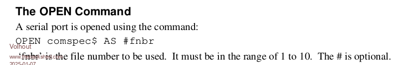

In LOC(x) the x is the file number of the file opened. The file number must be 1...10. Value of 0 is not defined. In the user manual.
Sorry about the <ctrl M> (carriage return. It was the other way around. You need linefeed.
