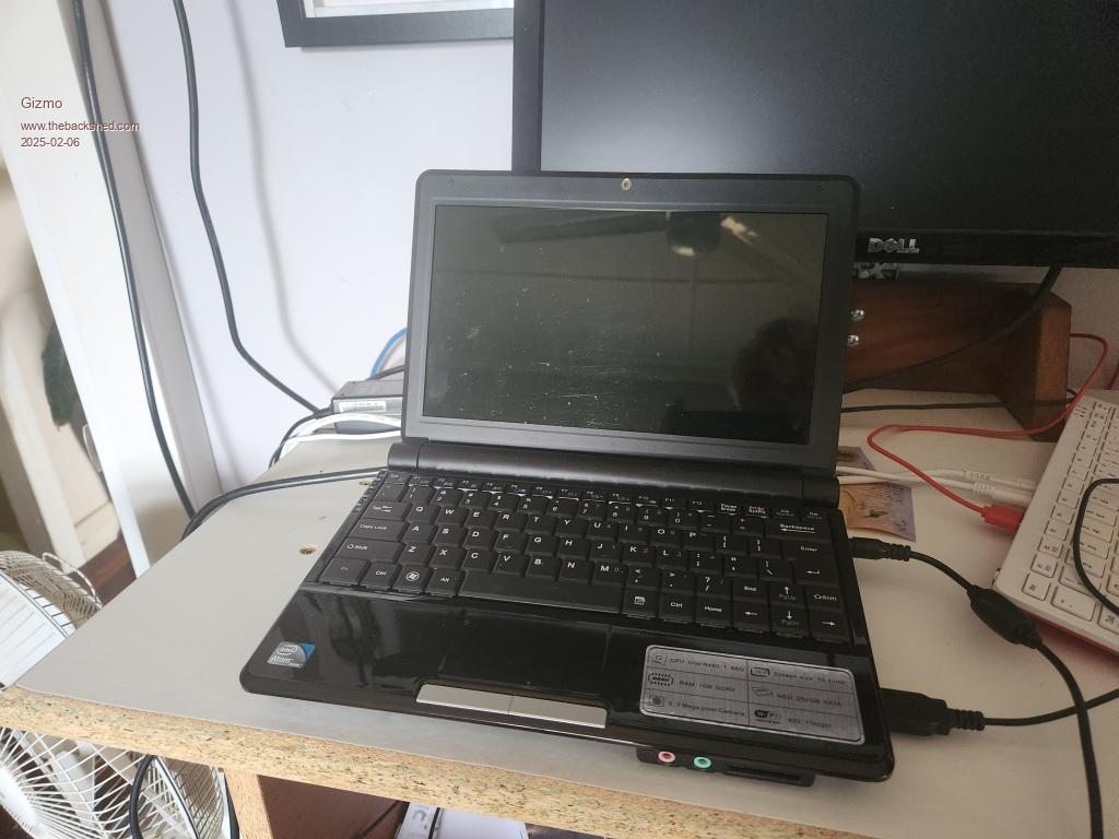

Posted: 05:54am 06 Feb 2025
I bought this netbook on the weekend for $20. It runs Win7 starter, has 1Gig ram, 250G hd. Intel N450 at 1.66GHz, web cam, 10inch screen, wifi and network connector. 2 USB, card adaptor, VGA out and audio
It boots up and runs fine, actually very snappy. Win7 complains its not authentic and its very outdated, none of the modern browsers will install.
So I'm wondering what to do with it. Tempted to install a Linux distro, any suggestions? Thinking maybe as a terminal for programming over a USB/Serial adaptor.

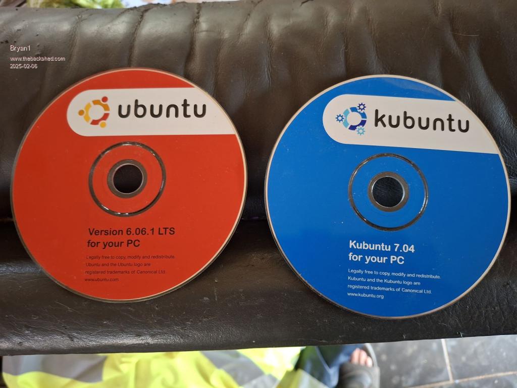

Bryan1
Joined: 22/02/2006
Posts: 2217
Posted: 07:54am 06 Feb 2025
Glenn I do have some old linux disks UBUNTU V6.06.1LTS and KUBUNTU V7.04 they are genuine linux disks too. So if you want them just sing out and PM me your address and I can send them off this week.
I did use these back in the days of 32 bit when a HD would fail on a computer and winsucks just wouldn't load. Now getting the net shouldn't be a problem using this old version.

Posts: 6038
Posted: 08:30am 06 Feb 2025
Bryan,
The n455 core is from 2010. Any distro before it (Ubuntu 6 or 8) will not have a kernel that supports the peripherals. The netbook is probably from 2011/2012. Earlies that would work is Ubuntu 10, but I know 12.04 has had a very long support time. That is probably your best guess, -or- the Ubuntu Netbook edition.
netbook edition
P.S. I have Ubuntu 8.04 disk. Nowadays you cannot imagine that anymore, but at that time Canonical send out FREE CD's if you wanted them. I received one in the normal mail.
Edited 2025-02-06 18:37 by Volhout

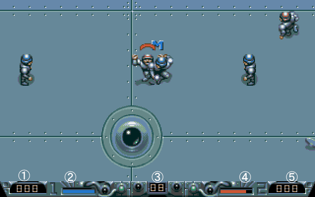

Posted: 08:59pm 06 Feb 2025
Maybe build a small Game-Machine
Batocera
'no comment
