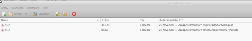

Secondarily, since its trying to build both for RP2040 and RP2350, ssi.h for hardware_structs and hardware_regs is missing for the RP2350 Platform (SDK-Version V2.1.0 and the latest SDK), but tries to include them. Simply copying them over from RP2040 to RP2350 SDK-Sources doesn´t work....

This is the output with ssi.h removed (NOT from the RP2040 hardware_regs and hardware_structs)- it isn´t part of the official SDK in the RP2350 folder anyway. ssi.h can only be found in the rp2040-folder

Nope, i used SDK 2.1.0 as required, freshly downloaded from the official sources. In /src/rp2350/hardware_structs/include/hardware/structs/ and /src/rp2350/hardware_regs/include/hardware/regs/, there is no ssi.h for the RP2350.
Only for RP2040 and the subfolders like above; its the only occurence where ssi.h pops up....copying them over from RP2040 to RP2350 will run into a mess while compiling
