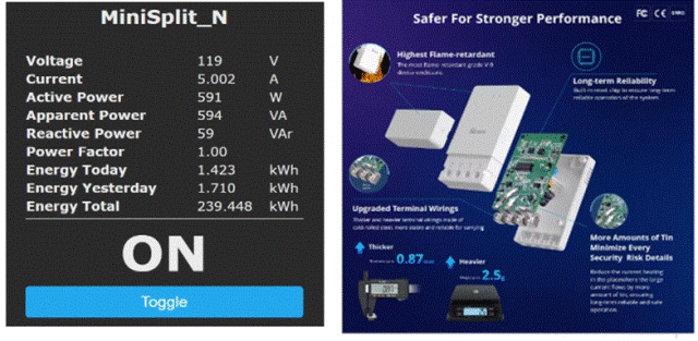

I have a number of appliances which run through Sonoff POW R3 16 and 20D mains monitor devices, flashed with Tasmoto:
On a Raspberry Pi 5, I use the Tasmoto WebUI to download the "Energy Today" value every 6 minutes--in kilowatts. This gives me 240 data points per device per day. I massage it in various ways, and then use the following MMB4L program to produce an html document which displays a chart using google chart.

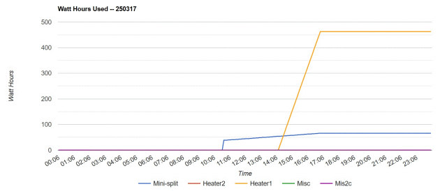

The program processes the input and fills an array with the cumulative kilowatt values for each device for each of the 240 time slots.
The program shells out to copy a standard header file to the output, then generates the data records for each time slot, and then shells out again to append a trailer file. Finally the output is copied to /var/www/html, from which web pages are served. Then any device on my network can retrieve it.
For this instance, I only have 2 devices running for part of the day. (My real application is for when I return to Canada in a little over a month.).

I apologize that I don't have a better example.

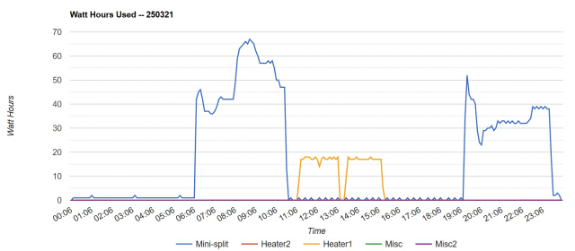

Here's the chart for kW per 6-minute period per device--in this case a 12000BTU heat pump (not having to provide much heat on a March Florida morning, and not much again in the evening) and a 200W electric heater:
To run this I took advantage of the options Tom provided for MMB4L to be invoked with parameters, so this runs the program:
mmbasic chartkwh.bas 250321 slot
The arguments tell it the date (250321) and to use the number of kilowatt hours used in each 6-minute "slot". (If slot is omitted, the chart will show always-rising lines of accumulated usage over time.)

The tiny pointed blips ("^") on the blue line show the mini-split using only about 1 watt hour every 2 hours with the temperature turned down overnight, and then during the day when no heat was called for, but with the temperature set higher, about once every 18-24 minutes. This is of course a level usage, and the blips only show when the JSON variable "Today" (cumulative kilowatt hours) increases by 1 since the previous 6-minute time slot.
