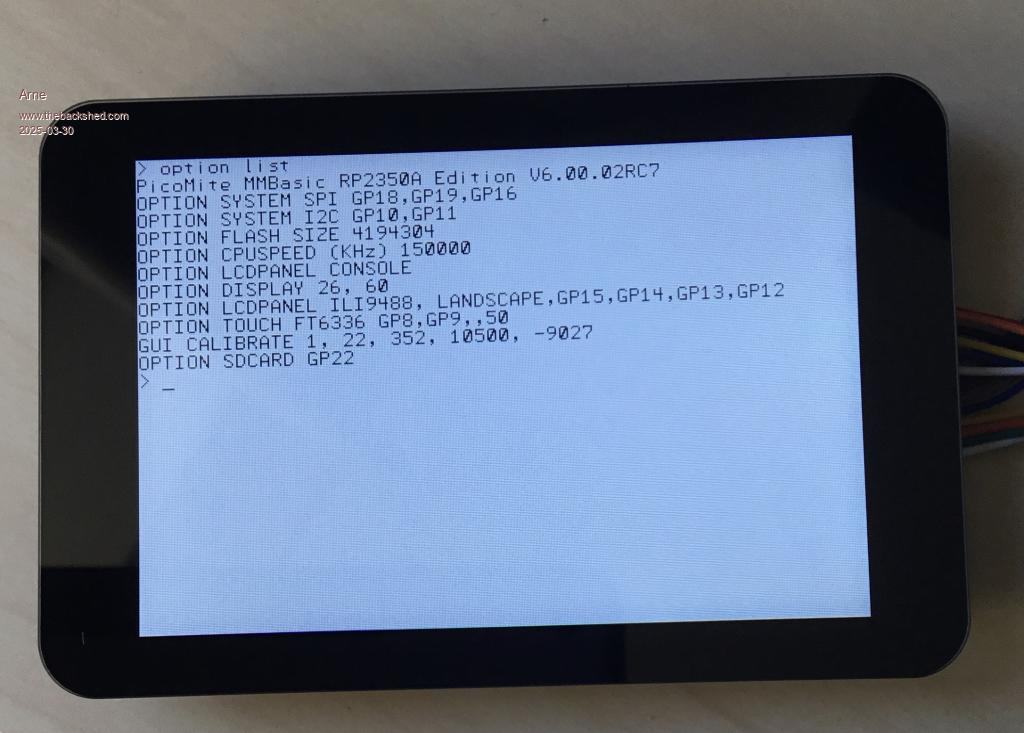

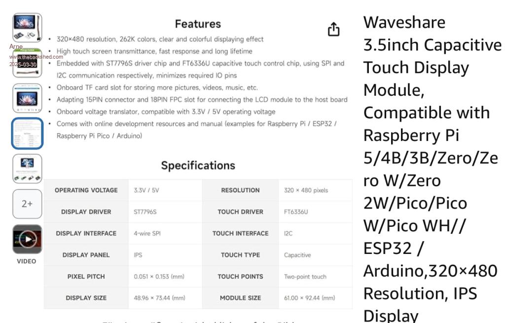

Has anyone experience with the following  3.5 inch capacitive touch display:
Touch and sd-card are working fine. Due no special display driver for the ST7796S
for PicoMite is available I tested following drivers:
ILI9481:
It has a white background,displays wrong colors and is slow
ILI9488:
ST7789:
Is for 240x240 res. only, displays mirrored ?
Is there a way to adapt one of the a.m drivers to work properly/faster ?

I have raised the cpu speed, now it is faster. My main problem is that the colors are not correct. They seem to be inverted.  I did not find a command to manipulate the color palette.
Do you have any idea ?

Don't know if it will work as the ST7796 isn't supported, but have you tried the INVERT parameter - manual page 55/56

In the PicoMite user manual on page 55/56 I did not find Information about  the INVERT parameter?
After your hint I tried  „RGB((RED% XOR 255),(GREEN% XOR 255),(BLUE% XOR 255))“ to invert the data.
This is working within the programming. At the console/editor I can live with the inverted colors.
Thanks Arne

OPTION LCDPANEL ILI9488, OR, DC, RESET, CS [,BL] [,INVERT]
e.g. OPTION LCDPANEL ILI9488,L,GP0,GP1,GP2,,INVERT
same for all the other SPI displays

Posted: 04:47pm 30 Mar 2025
@Peter
Now its working perfect. Thanks a lot!

I use the IPS display. ILI9488 AND ILI9481IPS are working. I prefer ILI9488 because it supports transparent text.
