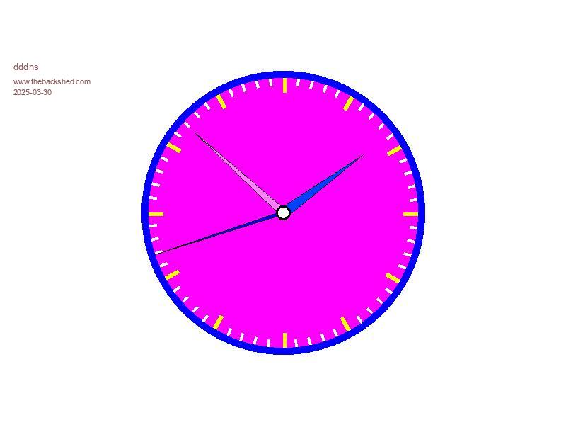

Hello :)
I setup my first VGA system and played. Outcome is a fully customizable and scalable analog clock. So nothing special but might be useful. Runs real nice and flicker free:

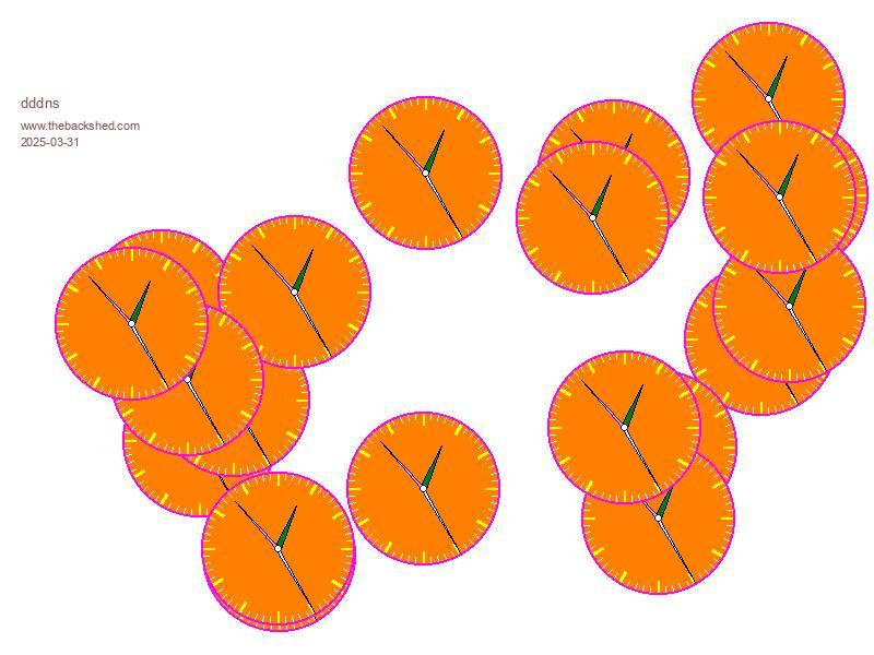

I realized, that this demo runs without PSRAM under RESOLUTION 640 and 720!
A simple "screensaver" made out of it:
analog_clock_screensaver.bas.zip

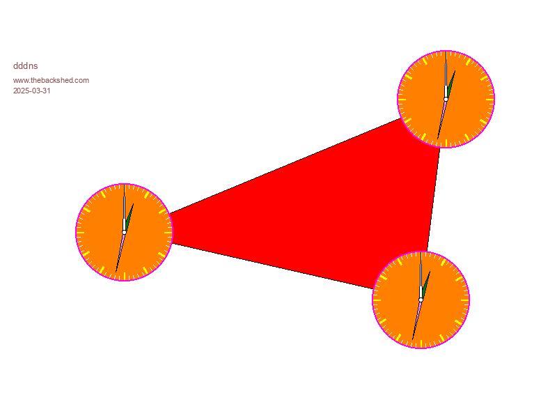

One more in this issue.
Two or more moving:
Tree or more connected through a polygon moving:
analog_clock_screensaverV2.bas.zip
Code could be optimized but this was just an exercise and I'm too lazy.
But if you like, do what you want with it :) have fun
