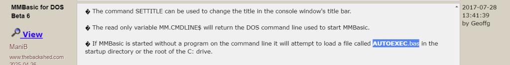

A long time ago wrote Geoff this note about MMBasic for DOS and the AUTOEXEC.bas file:
What's about the PicoMite?
Is there a possibility to execute a certain Basic program on initial power-up, such as AUTOEXEC.bas, if it exists?

Ahh, I found the FLASH SAVE 1 command with the OPTION AUTORUN 1;)

Sub MM.StartUp is another method.
If present it runs at Start Up.
