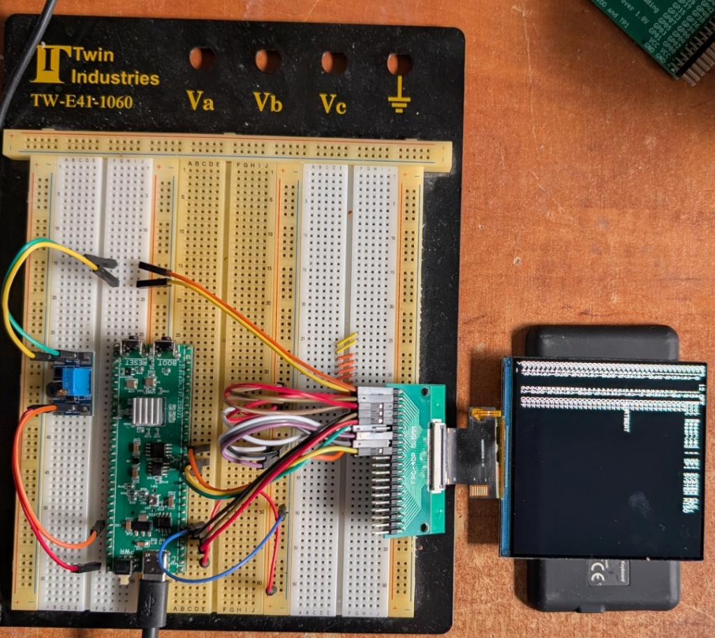

This display is available from buydisplay.com
It is a bright 4" IPS 320x320 display with 80 degree viewing angles. It uses the ST7796S controller and I will include support for this display in the 6.00.02 release
OPTION LCDPANEL ST7796SP, orientation, CDpin, RESETpin, CSpin,,INVERT.
As shown the display is in portrait mode which benefits from H/W scrolling.
Connection is a bit trickier than the standard "packaged" displays as it needs a FFC breakout (40-pin, 0.5mm pitch) and a boost converter to generate 15V for the backlight but it is ideal for building into any sort of device.
Wiring is:
pins 1,3,6,12,18: GND
pin 2: +15V
pins 4,5,13,14,15: 3V3
pin 10: SPI-CLK
pin 17: SPI-MOSI
pin 16: SPI-MISO
pin 9: CD
pin 7: RESET
pin 8: CS

For many applications well suited but not for editing text as with every 320 display.
IPS is nice.
I think this is a start of new generation displays. Seen this?
Posts: 12034
Posted: 02:19pm 08 Jun 2025
  Quote  For many applications well suited but not for editing text as with every 320 display.
Editing is now pretty OK with continuation lines. The display is as wide as a typical phone and bright and clear. Font 7 gives 53 characters across the screen.

That is a nice looking diaplay, and the specs suggest it would be close to daylight readable
Would you be able to read font 7 in the editor with less than perfect (think 50 year old / needs reading glasses / has done a fair amount of welding over the years) eyesight, whilst editing a program?

  Quote  Would you be able to read font 7 in the editor with less than perfect (think 50 year old / needs reading glasses / has done a fair amount of welding over the years) eyesight, whilst editing a program?
My 71 year old / needs reading glasses / has done a fair amount of welding over the years) eyesight, work fine with this display while editing a program

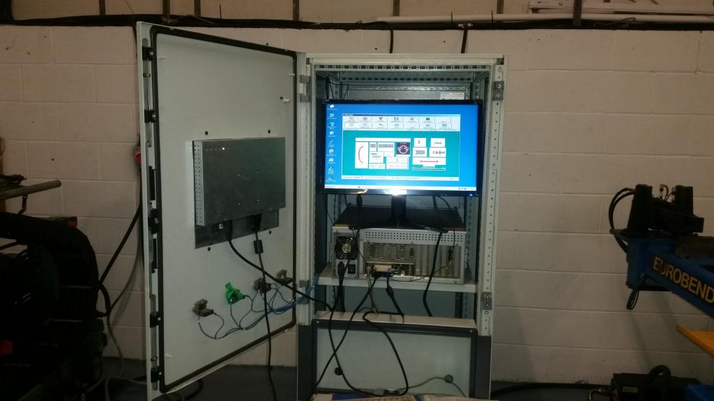

I recently showed my tablet on a factory floor, ten years and it's caked in oil and metal chips. Looks and performs like new. The next machine over has a £5,000
Siemens panel, only one year older.
The buttons are flaky and their mouse emulator is dead.
So this "industrial" control panel now has a desktop keyboard and mouse plugged in the back so they can actually use it.
I just LMAO
PhenixRising
Joined: 07/11/2023
Posts: 2098
Posted: 07:45pm 08 Jun 2025
This what I get:
"Industrial Control by Beckhoff"
Except the HMI is dead and now needs a PC monitor and keyboard. This is everywhere and the "yes men":
"Oh but it's worth the £5,000 because it's industrial"
Total BS.
Machines need to be making parts. Downtime is not an option.
PhenixRising
Joined: 07/11/2023
Posts: 2098
Posted: 07:59pm 08 Jun 2025
And BTW:The Siemens system? They want it ripped out because nobody supports it.
Machine builder: "Yeah it's fooked. You need to buy a new one for $500K"
Me: "It'll be better than new for $40K and open source"
