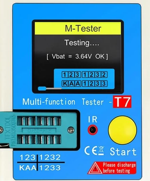

I have one of these cheapo component testers:
As I recycle many of my old parts and things I salvage from dead stuff, I use it a fair bit.
Two questions:

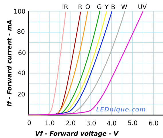

(1) How does it test LEDs?  Clearly it must ramp up the voltage and measure the current flowing through the LEDs.  If I was doing it manually I would plot something like:
The point the LED is "on" would be the first part of the linear portion of the graph.  Beyond that, the LED is "on" but just getting brighter.
I guess that for each step in voltage it calculates the difference in current levels.  In the linear portion, that difference would be constant each time the voltage ramped up.   Checking that my understanding is correct or if there is another way.

The odds are it doesn't go to that much trouble. My guess is it just has a series resistor driven by a Dout pin and an Ain pin to read the voltage. A look-up table to sat what voltage is what colour.
For a variable output voltage high frequency PWM and a filter will do the job.

It uses a resistor in series with the supply and monitors the voltage across the LED. When you put an LED into the socket the display will indicate Vf for the LED while the resistor limits the current through it.
LEDs are current-operated devices. The voltage across them (Vf) remains more or less constant as the current changes. They probably aim for about 5mA through the LED, but it could be anything from 1mA up to 20mA for small LEDs. Power LEDs will accept a lot more.
