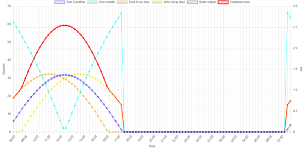

A program to estimate the output of PV arrays at any position. It can be used to compare multiple layouts. Handy when you are deciding where to place the arrays.
You need to enter your lat, long, timezone and the array declination (tilt) and azimuth(bearing).
eff is the estimated efficiency accounting for system losses and cloud cover etc. Using 0.75 agrees with my location.
directions are true, not magnetic.
The program assumes 2 arrays but you could add as many as required.
The program first prints the current days output at 15 minute intervals.
Then it calculates the total output of one day for each week of the year.
The code to chart the year output is commented out.
The noaaSun SUB is a translation of a NOAA spreadsheet.
https://gml.noaa.gov/grad/solcalc/azel.html
It's main purpose is to give the sun elevation and azimuth for any place and time.
The function arrayOutput() returns the maximum output of a PV array.
Before running arrayOutput() you need to call the noaaSun sub which populates the SUN.xxx variables for that time.
I used a simple cos() function to determine the output. In reality, there are many variables that could be taken into account but simple is enough to compare systems.
The ZIP contains the code with line continuation and a second copy with long lines.
Note that one line would be longer than 255 characters so I used intermediate temp variables to allow it to run.
If you use the version with line continuation, you must set OPTION CONTINUATION lines on
If your device or MMB4W doesn't have OPTION CONTINUATION lines, use the sun_angle_LL.bas

whats the meaning of these variables:
DIM array1Az = 90, array1Dec = 15 , array1Max = 2.5,
DIM array2Az = 270, array2Dec = 15, array2Max = 2.5,
Which variable contains the installation angle of the panels and their maximum output?
And how can I interpret the results of the day loop (the three values after the time, the last one is probably the sun angle)?
Peter
Posts: 6624
Posted: 09:39pm 04 Aug 2025
array1Az is the azimuth or direction the first array is pointing.
array1Dec is the declination or tilt of the first array in degrees
array1Max is the maximum power output of the first array.
The same for array2
I have two arrays both 2.5kW, one pointing east and one pointing west. Both on a 15 degree slope.
  Quote  PRINT thistime$,STR$(p1,2,3),STR$(p2,2,3),STR$(p1+p2,2,3), _
STR$(SUN.solarElevAng,3,1)
Time, power for first array, power for second array, total power, sun elevation.
