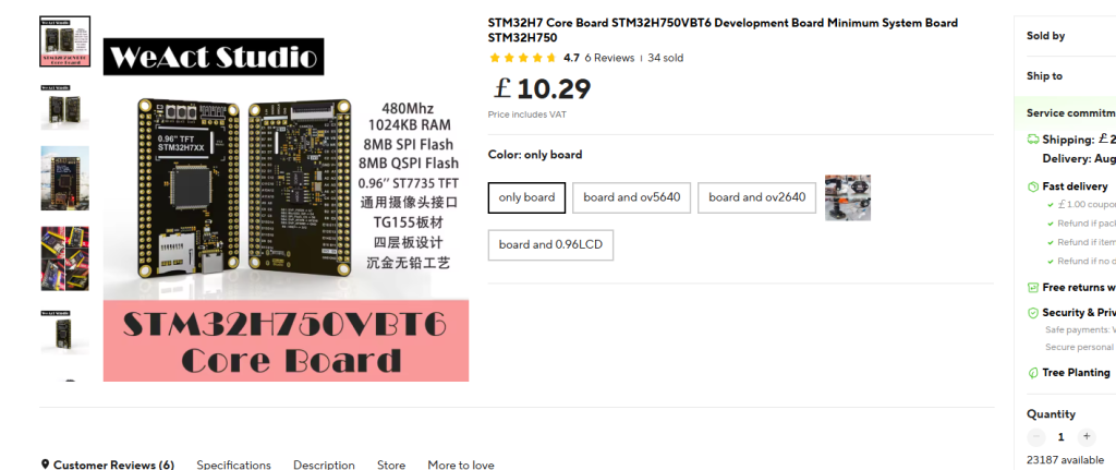

I was also wondering about:
Can't work - H750 only has minimal flash
