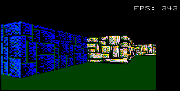

added different textures
added the Image RESIZE_FAST command for Win/CMM2
re-added View-Bobbing,
ccast091.zip
Have Fun
Martin
Edited 2026-03-06 19:42 by Martin H.
'no comment
Bleep
Joined: 09/01/2022
Posts: 868
Posted: 01:10pm 06 Mar 2026
Hi Martin, yes that's working fine, it's slightly slower than the previous version, About 15 to 16fps at 320x240 and about 8fps at 480x320.
On a HDMI 640x480 @378Mhz about 14fps
Or a HDMI 640x320 @252Mhz about 9 to 10fps
Or a HDMI 1024 (actually 512) @375Mhz 20 to 21fps
Regards Kevin.

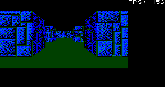

To speed up image rendering, you can set the variable resStep from 2 to 4. This will make the changes more angular, but only half as many scans will be performed per frame.
' --- Grafik Setup ---
Dim integer resStep = 4' Wich...
