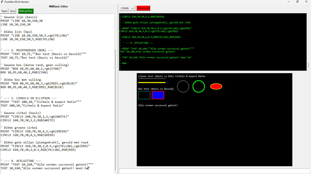

now can make some basic graphics whit stock picomite firmware if dont have a display
python code

now you can
import serial

class PicoMiteIDE:
   def __init__(self, master):
       self.master = master
       self.master.title("PicoMite IDE & Monitor")

   def run_code(self):
       """Stuurt de code in de editor regel voor regel naar de Pico."""
       if not self.ser or not self.ser.is_open:
           messagebox.showwarning("Fout", "Maak eerst verbinding met de Pico!")
           return
       code = self.editor.get(1.0, tk.END).splitlines()
       self.ser.write(b'\x03') # CTRL-C om lopend programma te stoppen
       self.ser.write(b'NEW\r\n')
       for line in code:
           if line.strip():
               self.ser.write((line + '\r\n').encode('utf-8'))
       self.ser.write(b'RUN\r\n')
       self.terminal.insert(tk.END, "\n>>> Programma verzonden en gestart...\n")

How did you accomplish that on the Pico side in MMBasic? Did you set up a virtual display driver (with OPTION LCDPANEL USER hres, vres)? Or via OPTION LCDPANEL VIRTUAL_C?
tenij000
Joined: 30/05/2025
Posts: 107
Posted: 09:40pm 17 Feb 2026
python script just looks for the user input then does the drawing if connect to pico whit drop down menu you can send code at left window also at right bottem a 1 line can use to send a single command
tenij000
Joined: 30/05/2025
Posts: 107
Posted: 09:44pm 17 Feb 2026
but how does that virtual display work
bfwolf
Joined: 03/01/2025
Posts: 258
Posted: 10:05pm 17 Feb 2026
OK, I understand: The Python script checks what the Basic program would do and then does it itself?
  tenij000 said  but how does that virtual display work
See in the latest PicoMite manual, page 104 for OPTION LCDPANEL VIRTUAL_C : The PicoMite just draws to RAM which could be read out and translated to GFX-teminal-command-sequences.
Similar with "OPTION LCDPANEL USER hres, vres": Look into the file "User
Display Driver.txt" packed with the distribution.
In short: You supply a few drawing functions/subprograms, which are called by MMBasic when drawing text or figures. So you always know what's going on and may translate/transmit.
