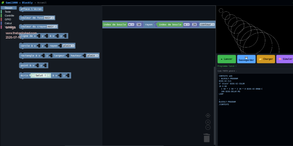

I’ve implemented 'Blockly' similar to 'Scratch'.
It’s a programming learning app for my 7-year-old granddaughter.
I’ve started teaching her the 'FORTH' stack philosophy... we had a lot of fun using actual plates!
Currently, 'Blockly' generates 'FORTH' code that runs on the simulation screen just like a real 'FORTH' script; 'LCD' screen control is currently being implemented.

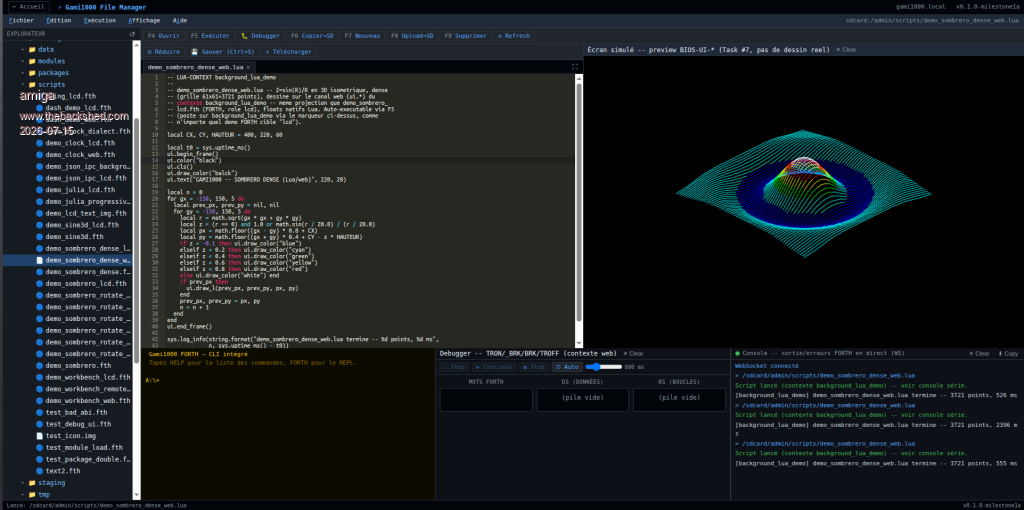

'Sombrero' coded with 'Lua' and execute in 'P4' with 'Lua' engine

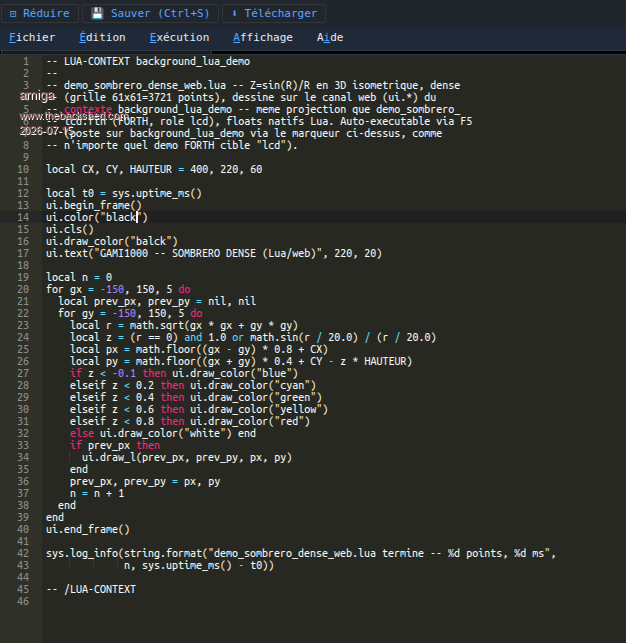

'Sombrero' 'Lua' code .
'Blockly' embedded in 'P4'.

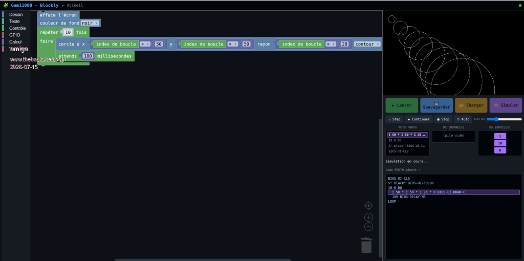

'Blockly' generate 'FORTH' code ,run it throught 'VM-FORTH' and debug with dynamic display stack's FORTH
