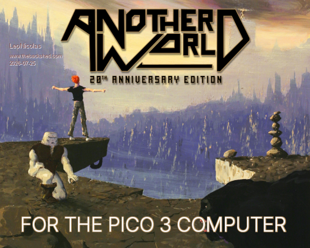

Another World video game micropython engine port for the Pico 3 computer
I don't have the board yet to test it running on a real hardware. The following video has been record on my laptop running the game on the Pico 3 PC emulator (Thank you Peter!).
Demo Video
Source code: https://github.com/leonicolas/pico3_python_another_world
Game files: https://www.gog.com/en/game/another_world_20th_anniversary_edition
Pico 3 PC Emulator: https://github.com/UKTailwind/micropython/releases/latest
How to run it:
1) From your terminal run the Pico 3 PC Emulator (./pc3emu) and close it. The first execution will create the ~/.pc3emu directory
2) Clone the port git repository to ~/.pc3emu/sd/aw where aw is the project root directory
3) Copy the game/DAT directory to the aw directory
4) From your terminal run the Pico 3 PC Emulator again
5) On the python terminal type
 a) cd("sd/aw")
 b) run("main.py",".","--pico3")
Play the game using the arrow keys or WASD and the space bar
To close the game, press Escape or Q
Sound suport is not implemented yet
