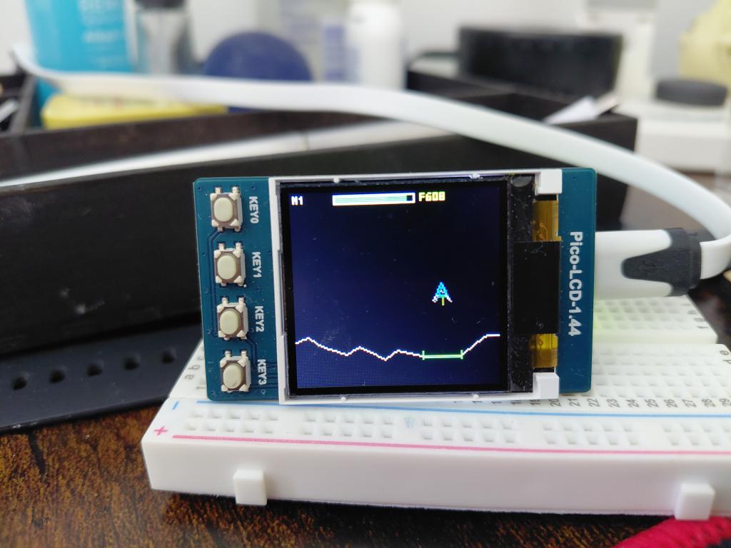

Hi all - lots of lurking, trying to keep up.
Not sure if this is Watchdog question or not.
I am coding an "attractor" mode for a static display - which cycles through demos of various games I have written (think Defener, Missile Command etc)  [Will post those else where).
The idea is to leave the screen running, boot the Picomite, select a game and play portion of the game, reboot and then pickanother -- this is then left on to cycle randomly though the games.
So far I have a Menu that is autorun on boot that looks like:
OPTION EXPLICIT
OPTION DEFAULT NONE
dim attract$ as string
SELECT CASE INT(RND * 4) + 1
   CASE 1
       attract$ = "defender.bas"
   CASE 2
       attract$ = "asteroids.bas"
   CASE 3
       attract$ = "lander.bas"
   CASE 4
       attract$ = "missile.bas"
END SELECT
chain attract$
This works, as in it selects a random game demo to load.
Each game has
Option Explicit
Option Default Integer
Option Base 0
Watchdog 10000
as a standard header.
On first running, as said, a game is selected randomly, loads and plays.  Then the watchdog kicks in and it restarts the CPU. BUT at that point the game just loaded restarts.

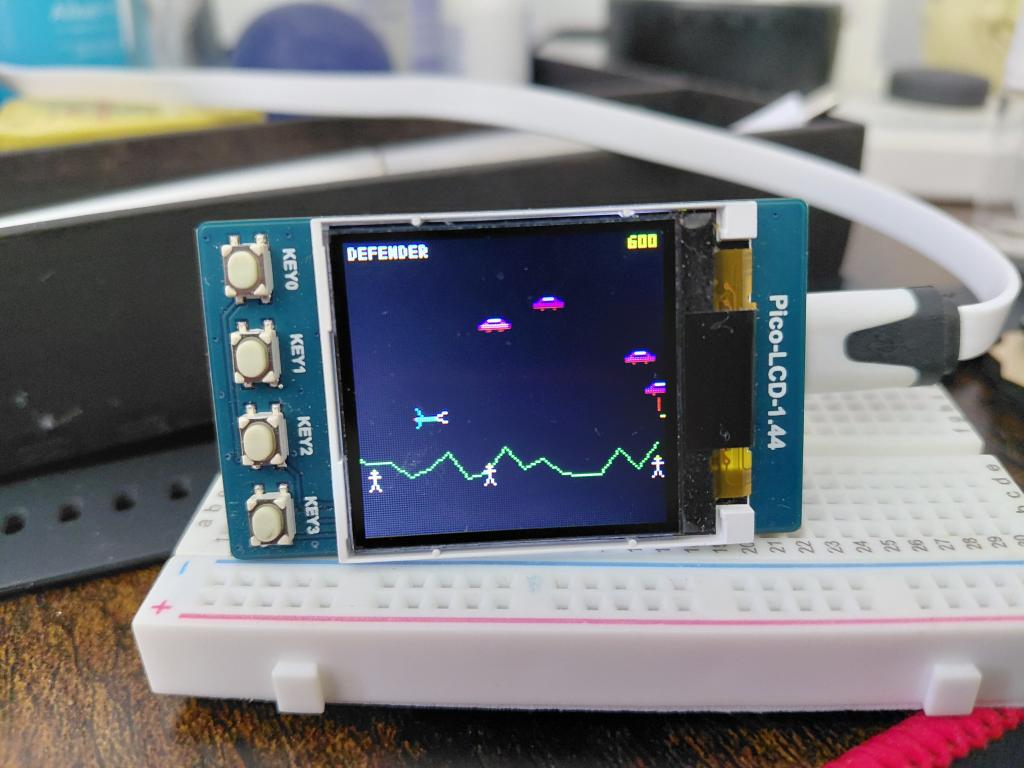

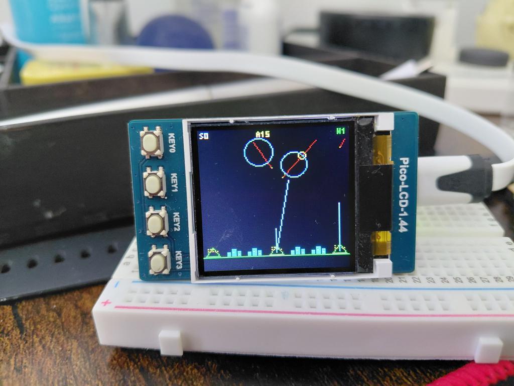

Current have "self playing demos" of:
Defender
Asteroids
Moon Lander
Missile Command
Tron (not great)
Gunslinger
SubHunt
Tempest (also not great)
Centipede
SeaWolf
Space Invaders
Arkanoid
Dino Jump (the Google game that plays when the internet is dead)
Pong
Plus Conway's Life and Matrix Rain)
And adding more - so would rather a menu that adding boiler plate to each one.

For clarity "all" that I'm looking to do is:
(1) Load a random file - let it run for a time
(2) Fire a watchdog reboot
(3) Repeat
The "issue" seems to be that rebooting after a watchdog doesnt fire off the autorun file but restarts the file that called the watchdog.
Will test with random tick interrupts in each file to load that way (but that feels like it will just work ;-)  -- not a biggie, but watchdog functioning differently than expected.

FWIW - the "games" are not real - in so much as the 'mite plays itself - there are no user inputs as I was going for the "look and feel" of these classic games - but they work in so much as the scoring mechanism and the game play is sort of like the real things.
The point of all this being to swap out the fake screen on this robot to a screen that cycles randomly through some periodish games and graphics...
