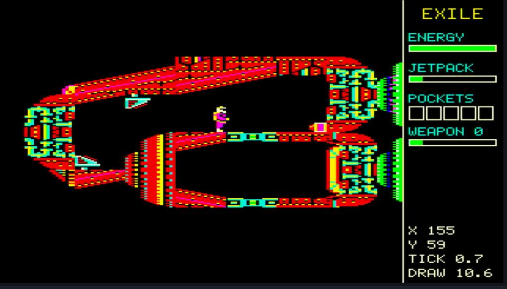

Posted: 04:52pm 16 Sep 2026
Exile.zip
I never knew this game when I owned a BBC Micro but it is quite extraordinary. It has also been by far the hardest to port to MMbasic so far. The zip contains a readme that tells you how to install and play it but you will need V6.03.02b7 or above to run it. You should also note it requires all three flash slots, two for the map and one for the library. It won't overwrite your current ones without erroring (flash slots) or asking (library)
You will need a connected keyboard to run it - USB or PS2. It may run on a picocalc (untested). It will run at 252, 315 or 378MHz, tested on HDMIWEB V6.03.02b7
Below is a short summary of the extent of the game and what the original developers achieved.

The processor is a 32-bit core at 378 MHz — **189 times the clock**, with a far
better instruction set and hardware multiply. The game logic, transcribed
instruction for instruction into C, takes **0.28 ms** a tick. Drawing the frame
takes **6.8 ms**.
They did the logic *and* the drawing in 40 ms, at 2 MHz, in 8 bits.
